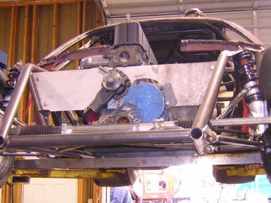

bubba this is what i found, I could not find a listing for the 53-1140. Maybe if some one has a 72'-76' catalog I checked in my 70' which had a different parts # system then newer catalogs. I also checked a 78' and a 2000' .
53-0240;
57-64 fairlane, Mercury 240/300, 1 3/4" X 34" rear sect is fenderwell exit, wont fit w/ webers.
53-0304;
60-67' Falcon, Mustang, Fairlane, 240/300 1 3/4" X 34" needs special motor mounts,will work w/ webers
53-0560;
68'-77' Mustang, Maverick, Comet 240/300 1 3/4" X 34" needs special motor mounts, will work w/ webers
53-2544;
Front or rear engine dragster, 1 7/8" X 32"
As for a front motor mount,here's a closer view of mine, Basically the 4 bolts for the waterpump and 2 more over by the timing cover are it to hold the motor.I'm also using a sbf midplate pattern.
The wheelbase on the Pinto is stretched 6". The back of the block is right up next to where the firewall will be, I was going to run a Clifford 3 2V setup later but because of the setback the rear carb would be under the dash behind the windshield line I'm not.
