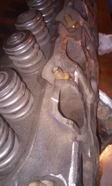

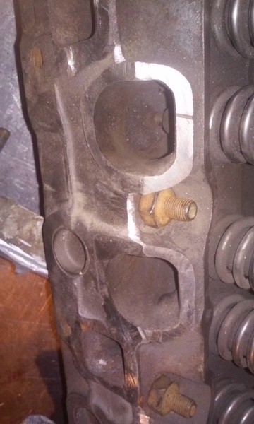

I took a few pics showing the size of the intake ports and the angle I cut the tops off; toward the valve cover. Plus with some studded head bolts inserted to provide an anchor for eyebolts to attach the new intake. I cut the angle because I want the intake lower; coming out level instead of upwards. The upper section I angled off was the inner radius of the curved port; it will be a smooth transition without any severe angles. My head is cast steel as denoted by the grinding sparks; light yellow and very long, instead of short orange like cast iron. I'll try again later to upload pics. I just want one small four barrel, like a 390 Holley or an old WCFB Carter or Four Jet Rochester. Something about 400 cfm with vacuum operated secondaries.
ok here we go
I wasnt planning on having a flange on the head; only on the intake. O-bolts from the head studs to hold it on and a few alignment pins to keep it in place. I need the carb low so there will be a curve down where it comes off the head.
Look at the bottom pic top port does that port look small,bad ? I can see the whole valve, with a high port with the wide funnel entry cut off. These late model heads are no after market race head but fix the one opening with a couple carb bores closer to where they are needed. I do not think they are the big dog people think.
