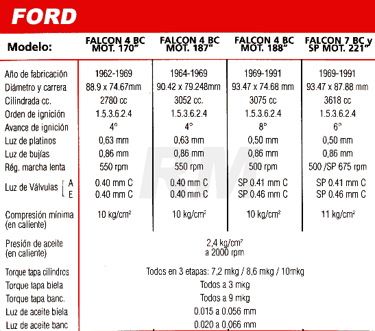

thanks for the info xtaxi, but here we also have the 187 4 mains, whats the difference with the 170??
look, with the 170, stock pistons, sp head ported and polished, 2 barrel carburetor (the holley 2300), mild cam and headers, balanced alternative mass, sinterized clutch, and a 4 speed gearbox, limited slip diff, can i get into the 17 sec in 1/4 mile?? 17.20-17.80 this is my goal.
but there are differences with the aussie or US 170, those cars has better performance. 0-60 in 15 sec (the argie 170 0-60 in 21 sec) standing 1/4 mile (402 mts) in 20 sec, the argie 24.8 in the 500 mts (0.31 mile).
If you want to keep the stock block, grab 187 psitons and crank.
http://www.rm-competicion.com.ar/imagenes/datos/falcon2.gif
The 187 was a scramble of existing componets in the short 144/170 block. If you check through the details on Toro, you are perhaps aware that the 200 I6 is the same physical size as the 144, and 170?
187 had 90.42 mm pistons, 60 thou over (+1, 52 mm)
It used the four bearing US 200 CRANK, 3.12"
The 188 used a 221 tall block with seven bearing 170 crank
Argie 221 ran same crank as aussie 221.
The famous Argie race cars have a 'tall' block 188 destroked to 2.76 stroke and over bored to 183 cubes. This engine uses the Chevy 305 piston sizes and the 187 crank stroke.

thanks for your help xtaxi, so i can make it 187 over boring to 90,42 mm using the STD high compression 187 pistons , the 187 crank, but the rod and bearings are the same right??
I'd guess that the 187 had 200 rods.
The 4 bearing 200's and all 200's ran 4.715" rods.
I'd have to go over the posts addo has on 144 and 170 rods. They were about 4.855" and 4.815" respectively, from memory.
