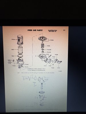

I replaced the fuel pump and was too high on pressure. Bought another Carter and summit sent wrong pump. Is the canister filter on top or bottom. The lever connector to cam right make contact on top or bottom. Can I post a photo on this site?
Finally found an illustrated parts list showing for 63 Falcon 170 six. They were sending ones with canister on bottom and actuator rod on bottom. Opposite of what I need

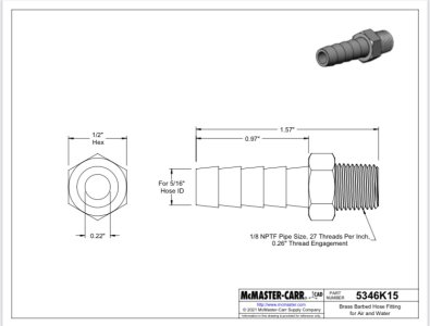

About inlet and outlet size difference.
The pump your using, and the one I listed on post #6 have the exact flow rate. The benefits of the 1/8” NPT inlet and outlet is, the fittings are the exact size for 5/16” fuel lines. This makes a much simpler installation. The flow restriction is not at the 1/8” NPT fittings on the pump. It’s at the needle seat in the carburetor.
If I took my time and went through all the models listed carefully earlier, I probably would have talked to you about the one I just listed. Both pumps are good, again, they both have the same flow rate.
The benefit of the FAC-FEP289SV Pump kit is, its complete. And its price is cheaper than just a pump and it would be a clean, simple install.
Here is a 2D CAD drawing of the barbed adaptor. The through hole is 0.22”. It’s plenty.

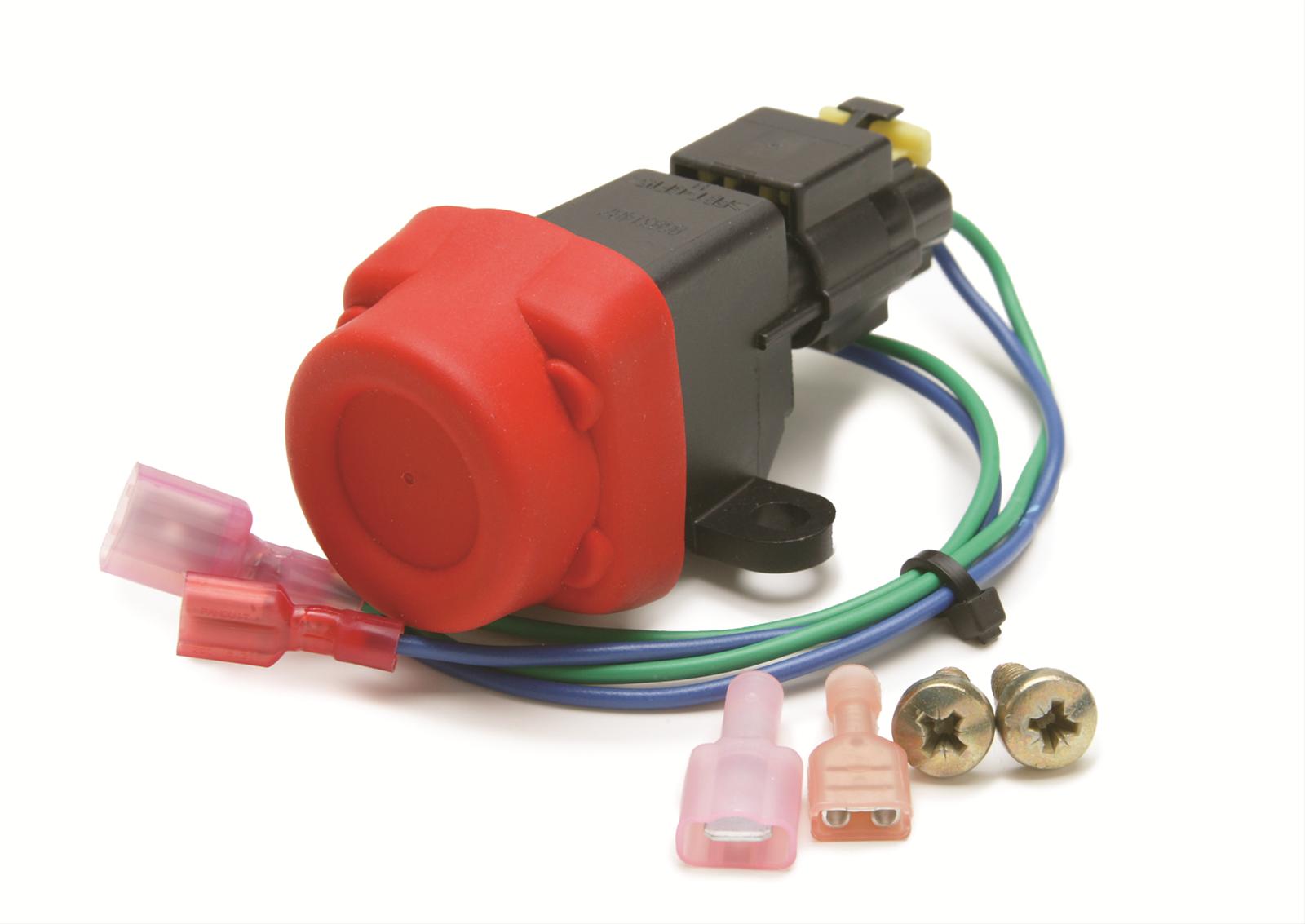

It would be best to install an inertia switch while you’re at it. The thought of the fuel pump not turning off if you’re ever in an accident and become unconscious just does not sit well.
Better yet:
I cant second this comment enuff. Reason Y I dont use the ele - fires.
Glad some 1 else did as I feared entering it yet again. Unconscious can be
more than a knock on the head. Getting in a bump-up creates absent mindedness.
Will U think of the switch, no you’ll B cursing the other driver, situation, or taking care of
other things, not thinking “Oh, yeah, let me flip the lill switch."
/OR/
as most do - there is no switch...
