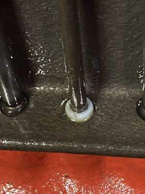

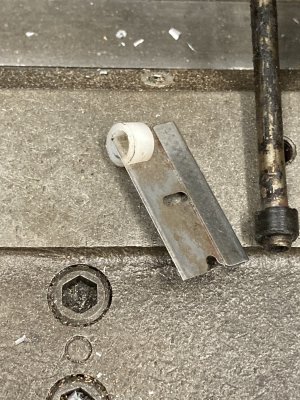

You could fab one up from the correct diameter tubing. FWIW I added a press fit Teflon bushing to hold mine a little more securely. I don’t think the rubber bushing is included in the gasket kit.
