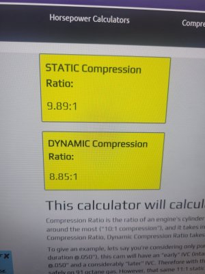

So I got a 250ci from a guy who pulled it from a 74 Mustang. I started to build it (it had evidence of recently being machined) and went with the pistons out of that oddball V8 Ford made for like two years in the early 80s. Forget the displacement. Anyway, they're essentially flat-top pistons, with like a 1 or 2cc dish where the valves come down. Originally I was calculating everything out for the compression ratio using the stock head with some porting and valve train work. The V8 pistons were the quicker and cheaper way to boost the compression since I would have purchased new stock ones anyway. That way i didn't have to have the head machined since it was all fresh anyway. With all that, it would put me around 9.1:1, which I thought would be great for a daily with a little more oomph. Then, Vintage Inlines came calling. 20 years after I put my name on the damn list for the aluminum head, he suddenly does a run of 30 or so and I was eligible. I hadn't even thought about it since the guy from phx passed away and it seemed like the head went with him. Anyway, I had just got my bonus from work and decided to blow it on the aluminum head. Problem is, he says the chamber is 55cc. With that, my CR jumps to roughly 9.9:1. That seems super high to me for a daily driver on pump gas. I plan to run an EFI system on it, but my question is, do I need to scale that CR back a bit? I'd hate to go through the hassle of swapping pistons again (they're already on the rods, ringed, and installed in the block with ARP rod bolts locking them down), but I'd rather disassemble it all and start over if that high of a ratio is gonna grenade my block or my brand new (expensive) aluminum head. Anyone have any tips here? Is that CR as outlandish as I think it is, or can I get away with it as a daily if I run 91 octane and don't hot rod it everywhere? Thanks!

Sorry for the absence! The Cody Fire in the Catalinas did more damage to our homestead than previously thought. I won't bore you with the details, but I will say that the bureaucracy of both the electric company and the county are on levels that would make a soviet politburo clerk blush. To answer questions in order:
The dynamic is like 8.8. See pic. I know our esteemed colleague from down under says dynamic is unimportant, but here it is anyway. And to answer you @aussie7mains, the piston sits .075 into the bore. But that with the (essentially) flat tops and the 55cc head puts me well above where I wanted to be. And 91 octane here is as high as we get at the pumps, at least in AZ.

I don't mind a bit more compression, but I don't want to have to run high octane and have low MPGs while worrying about a rebuild every 35k because I accidentally built a race motor and put it in a daily driver. Just trying to modernize old tech enough to have dependable transport with a little style. Thoughts?
