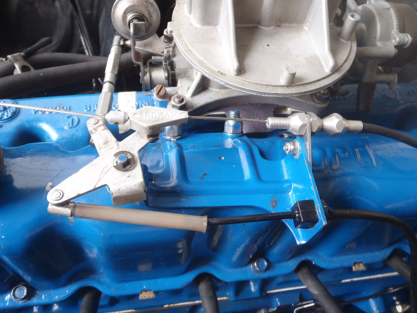

On jaharnes 250 Ranchero, he uses a Lokar AOD kicdown which eliminates the need to use the lower kickdown bolt hole on Holley, Autolite and Motorcraft 2-bbl and 4-bbl carbs. The "low down throttle arm on these carburetors and the proximity to the valve cover is always something of a challenge"
In fact, three guys on our site 62Ranchero200 , Luke76 , jahearne have taken care of this by using the Lokar kit.

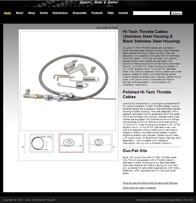

jaharnes, is your kit Lokar-Ford-AOD-24-Throttle-Kickdown-Cable-Kits-KD-2AODHT and DP-1000HT?
What Part No Lokar kit is this exactly in the Summit cataloge, and will it work okay with a 1970 Mustang throttle cable a forward mounted 4412 500 cfm Holley and C4? The rocker cover is the pinch point on it, and I know this kit will solve the problem best but need more details.

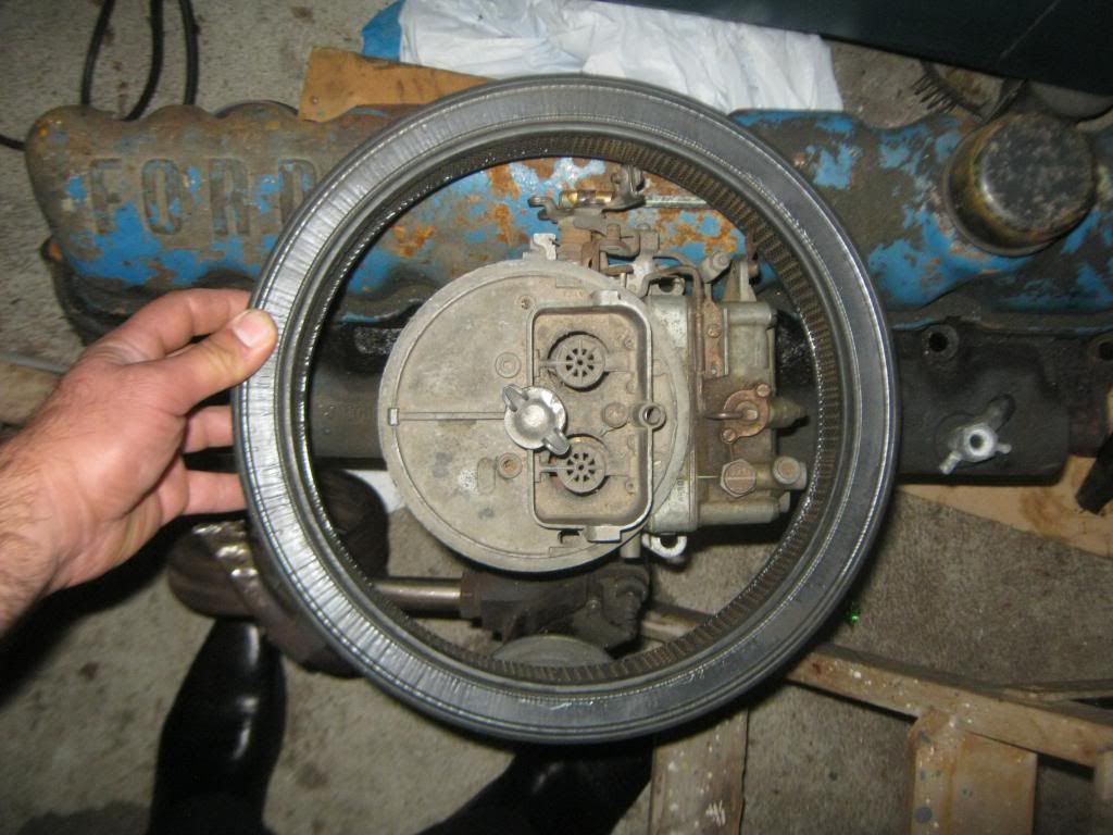

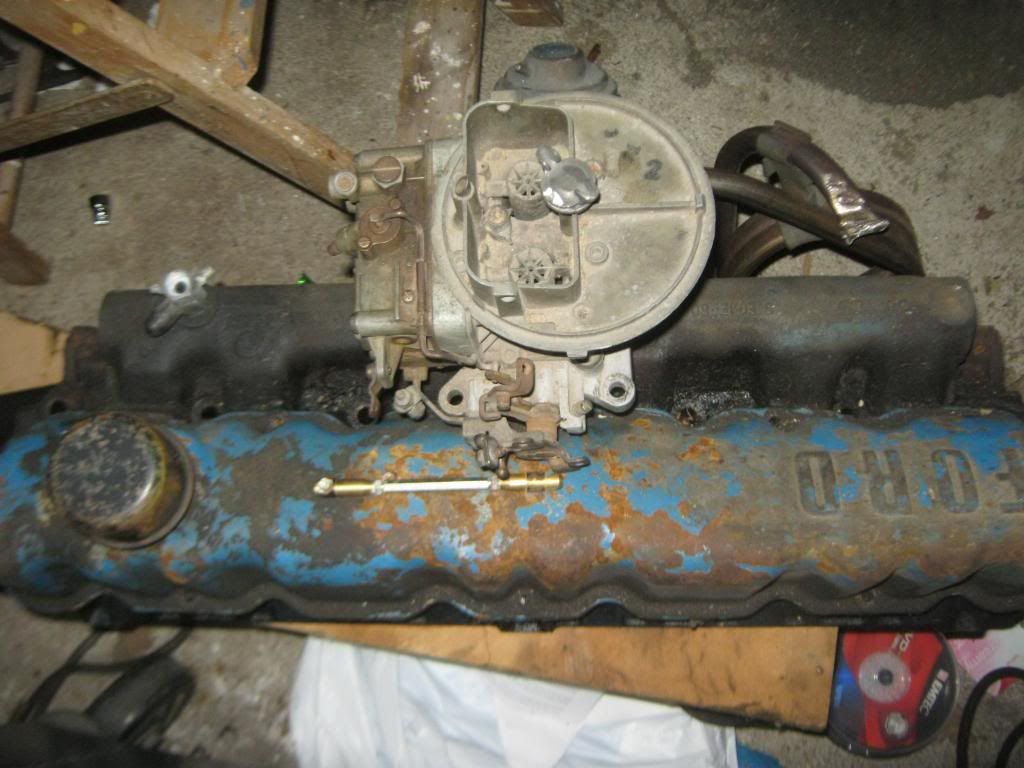

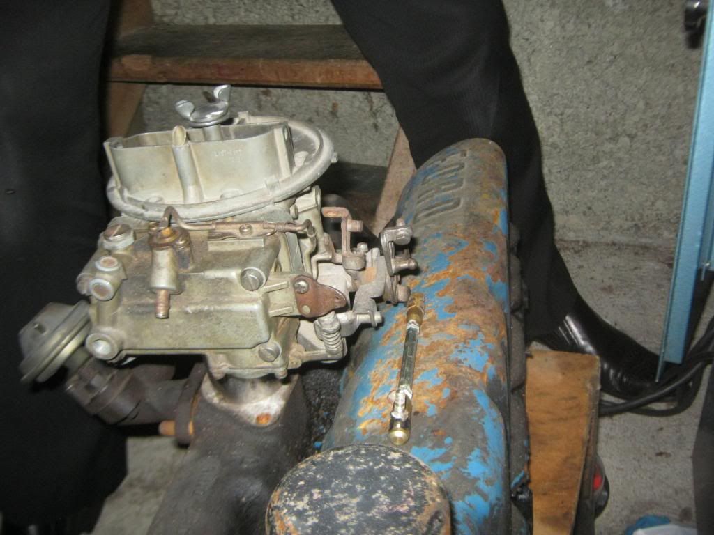

I'm turning my carb around float bowel forward, and using the Lokar linkage exactly as yours, but with the linkage 90 degrees around like these below
The following shows what I've done. The kit I want to use is yours, with the bottom linkage bent back like Kenneths to clear the rocker cover, then linked with the long rod, and then back to your set up. That gives me a lot of reduced height, and allows me to shave down the air horn, low mount the air cleaner and keep it all under the hood for a 70 Mustang 250, and a 250 engined Fox Mustang.

Sorry for the delay... I just happen to be in the neighborhood. The Lokar cable is just the AOD Ford carburetor cable kit by itself, KDP-2AODHT only black plastic instead of stainless. The throttle cable is from a 1970 Mustang 250, which was difficult to find; got it on eBay. The 302 throttle cable is too short and the 250 throttle cable is a bit too long, but it works just fine with a repo 1970 Mustang accelerator bracket/pedal that looks real close to the original 1967 pedal. It looks like the Lokar dual pak should to the trick. The fact that it is readily available makes it a bonus.
