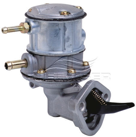

FPM-008 Carter, direct bolt on. Use a return line to your tank, do away with the regulator.
Suits 110 to 150 hp net.
http://www.ebay.com/itm/Fuelmiser-Mecha ... 1952232305
"Fuelmiser Mechanical Fuel Pump, FPM-008 fits FORD AUSTRALIA FALCON 3.3 200ci"

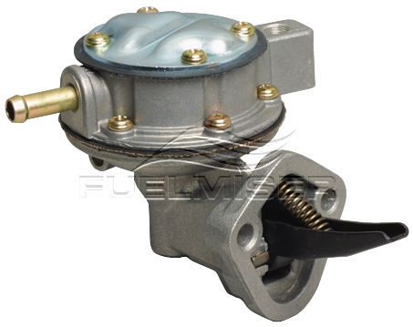

Second option, 1966-1983fuel pump .Our engines weren't stranged by emissions gear, and gave net readings of 93 to 149 hp (130 to 170 hp gross)
FPM-000A pre 1982 Bendix made Carter A31223 non bleedback pump.
http://www.ebay.com/itm/Fuelmiser-Mecha ... 2014302743
viewtopic.php?f=1&t=72720&p=558913#p558913

Do the 1st 2 in the 1st 2 pics get mounted 'upside down' (from that displayed in these pic)?
while the rest "right side up" as depicted in the pic?
Thanks for the links, pic and details on mounting…
BTW: what if you use them in lower gpm applications?
Anyway that fits. As stated in the link, you could mount em upside down if you needed to. Originally, though, they were AC style Glass bowl types.
Then went metal lid. Base 3.3' low compressions from 1976 to 1979 were just 102 hp engines.
