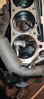

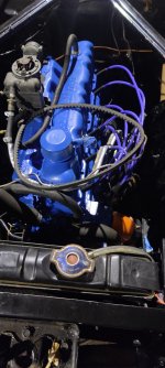

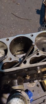

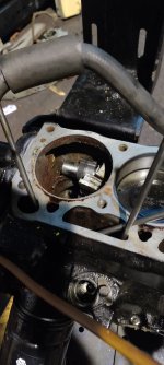

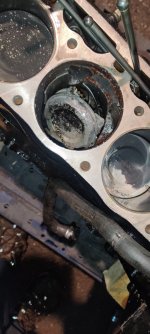

Some pics of the original engine failure after rebuild and new one.

Hi dmc1, wow that did some serious damage to the old engine but am glad to see that you got the newer engine in! I am sure you will get it going soon and I hear you its hard to get out and do things in the really cold weather its no fun at all. Best wishes.
Hi, since the new engine had a 3 speed I hope you removed the pilot bushing from the crankshaft. Seeing those busted pistons has me wondering what went wrong. Those pistons are hammered. Did the engine ingest some metal or did a couple of valves drop? Good luck
It looks like the block was sleeved with no shoulder for the sleeve to sit on, sleeve slid down some, now the piston rings now opened up to the bore that was made for the sleeve, and when the piston went down all hack happened.
