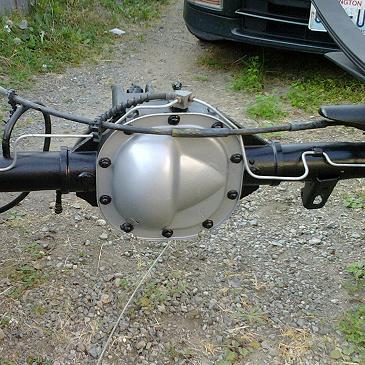

That and other posts never mention the 7.5 axle. I have a 7.5 axle from a 2000 ford ranger. I forget the ratio at the moment but not important.
I know they are 5 lug and I want to stay with my 4 lug (7.25 rear) axles so the flanges will have to be drilled. The axles tubes will have to be shortened, spring purchases will have to be relocated, etc. I am in Virginia and the pick and pull yards do not have old cars so It was either this or 8.8 which I do not need as my falcon is not a performance build. I can always buy new axles after shortening the tubes. I picked this axle as there are a variety of gear ratios available. I was interested in the weight and this appeared to be the lightest.
What is the opinion of these axles?
