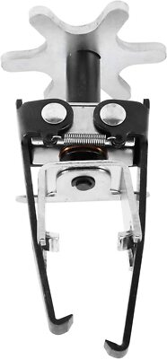

Replacing the Valve Stem seals is Cheap and easy with very few tools plus a valve spring compressor like this I have had a Lisle 16550 valve spring compressor since the 1960's it works great for these type jobs here is a low cost copy of it.
I used that spring compressor to change the valve stem seals out countless times on many different engines with the head still on the Block its about a 1/2 day job, that should be one of the first things you should do. Hopefully your not also be over filling the engine with oil these 200's only need 4 & 1/2 quarts if your using the standard Oil Filter like a NAPA 1515, there are larger Oil Filters to so than you would use 5 quarts of Oil.
