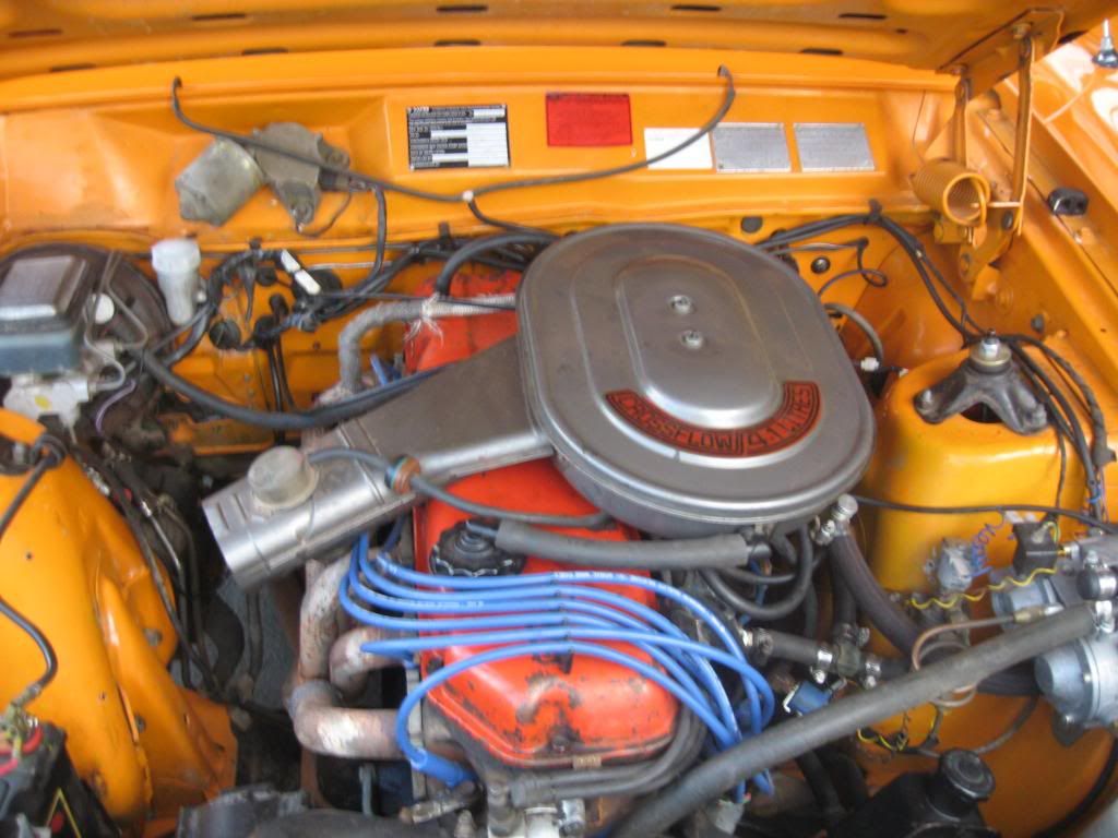

I have a '62 Ranchero with a x-flow. I would like to relocate the alternator to the power steering side of the engine. The drivers side in Us and passenger in Australia ( I have a power steering bracket but I do not use it).I thought maybe a alienator from a US 250 could be modified? But they are hard to find. I hope someone has an easier idea. Thank for any ideas, Ken

So I think its best to get the late Fox 3.3/200 air pump bracket, and put that on the X-flow to mount the alternator.

I'd try either the Fox 3.3 air pump bracket, or the Pinto/Fox Lima 2300 alternator. Each should fit better. The XR4Ti Merkur, EFI Tbird Super Coupe or SVO or GTTurbo Mustang should have the brackets to match the power steering.
The L and C code 250 engines with drivers side alternator might work, but it looks like they might come close to hitting the head or intake. The Aussie and US 250 have similar hard dimensions.
Stock US drivers side Aussie York/SelectAire or Motorcraft twin piston A/C units with power steering weren't made in great numbers, although I've seen one before, its easier to use the American parts and hook them into the power steering pump bracket.
