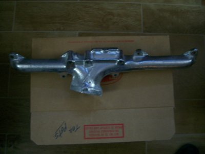

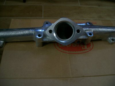

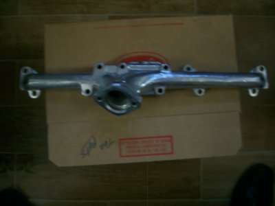

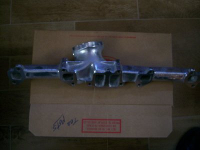

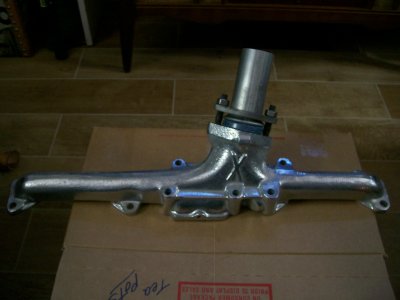

I have one of those that I had JetHot coated. Paid $139 at the time plus shipping, plus $300 for JetHot. Still have it & never used it yet.
Good for clearance if you have AC & can't modify compressor mount brackets for use with headers.

Aussiespeed has a two outlet manifold that would be far better than this. Thats basically a stocker, wouldnt help much.
I had one of those a few years ago. The two outlets seemed quite small to me. IIRC they were just a little over 1.5" diameter each. It was pretty expensive also, not including shipping. Oh, I guess they were 1.75", according to another post.
Remember that each outlet is only serving 3 pots, and in the case of a 200ci, thats 1.5litres per outlet, 45mm is plenty for that.

What type of connection is it for the oem manifold? I'm familiar with ball and socket exhaust but it's clear that these aren't the same.
The exhaust manifold has a beveled recess around the outlet. The exhaust down pipe has a small flare on the end, with a collar behind it. There's a hard donut shaped gasket that goes in between them, and the collar is drawn up to hold them tightly together by the two studs on the manifold outlet. This is not meant to be a flex joint. There is a small sort of hook shaped bracket bolted to the side of the block just below the exhaust outlet used to fasten the downpipe there via a standard U-bolt pipe clamp for a strain relief. The whole exhaust system is hung by flexible straps to allow a little movement when the engine rocks under load.
