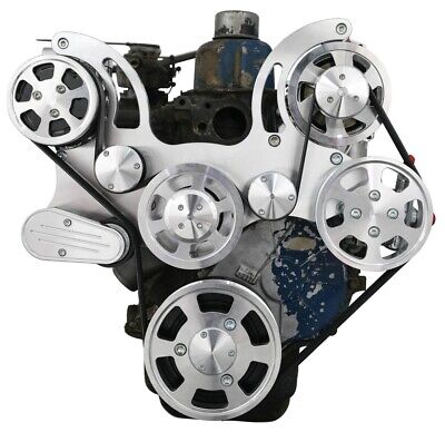

Nice to know the aftermarket is really expanding for our old engines. It's a lot of money but I guess the price is right considering what it comes with. Makes me glad I've been saving a spare block now that all these new parts coming available.
Is the Ebay address pic photoshopped? I'm only asking because there is no thermostat and it doesn't look like a lot of space to install one
I added the main website and it has more info and it comes with option to T stat housing in the listing from CVF racing site.
