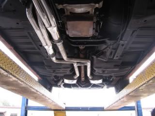

I'm running a 3"collector Y'ed to dual 2.5", (2) Spin Tech mufflers then over the axle and straight out the back. All mandrel bent....
And I'm Ditching the Spintechs for a pair of custom made mufflers from the exhaust shop I am employed at.
(The mufflers are built by Thermal Research and Development, think of magnaflows with way better look & quality)
Until a turbo and 3" downpipe are installed, Im just using the stock manifold and pipe stretched up to bolt to the 3" collector flange.
Definately want to redo it tuck it up, I did a bad job, but it's when I just started working at this shop.

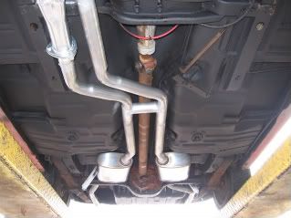

I have a 6 into 1 Clifford header, 2" pipe all the way back to a Flowmaster 80 series; single inlet, dual outlet. Mounted the muffler Z28 style, right behind the rear axle. I really like it. Sounds great!
