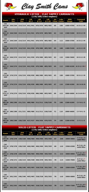

Clay Smith has been a good go to for a number of years. I really like the 264/274 110° that I have. It's the older grind with slightly more lift than what is on the new card.
