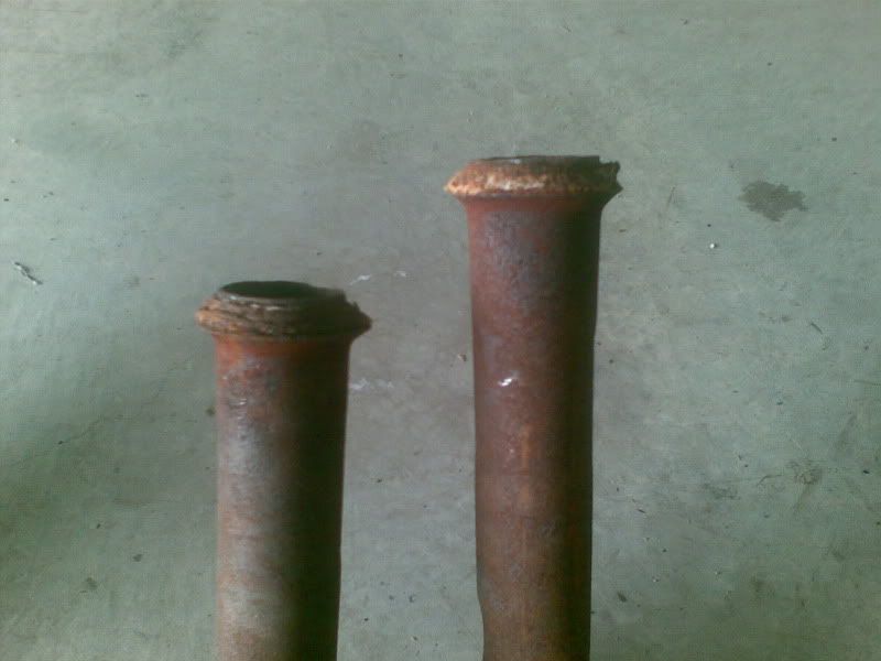

which can be divided up two or four ways. The single approx 4.25" hole can then run two exhaust pipes, sort of like this Opel 1900 twin carb header
one pipe can then go under or through the sump.
That allows you to run a 5.0 style full dual exhaust system, even with quad pipes if you wanna look like Daniel Boone packing a Pen Long riffle.
The stock 4.25 " exhaust football converter B and X code 3.3
It can be divided up into two pipes, and then one led under the engine to the left, and the other to the right, so you can run a V8 style exhaust.
