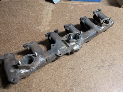

I've been working on a project which involves converting a stock log intake into a triple carby manifold. As you can see in the photos Ive simply welded on 2 additional carb mounts between the runners for 1 and 2 as well as 5 and 6. The plenum is completely open. No segregation.

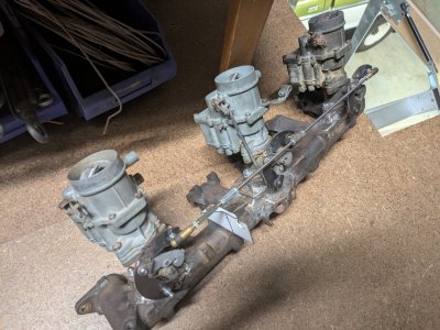

Here you can see it fitted with 3 single barrel Stromberg carbs (1 1/32 venturi) which flow about 162cfm at 3"Hg or if converted to compare to 4-barrel carbs, which are measured at 1.5"Hg 1 1/32" = 114cfm. Either way it provides a total of over 340 cfm. I havent run this set up yet.

Nice job on the intake manifold!
The 3 carburetors give you very even distribution. If you connect the 3 inlets with a single plenum you would lose the even distribution while also adding 90 degree turns. You would be better off using the Offy.

If you make a plenum that is bolted across all three inlets on the intake manifold, the outlet tube from the turbocharger will enter the plenum at the center of the plenum directly over the center inlet that services cylinders 3 and 4.
Cylinders 3 and 4 will get a direct feed while the air/fuel mixture going to 1, 2 and 5, 6 will have to make a 90 degree turn and travel down the plenum before having to make another 90 degree turn to enter the inlets.
One option would be to have 3 separate equal length runners coming from the turbocharger that go to each of the 3 inlets on the intake manifold.
