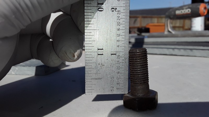

Followup on FW fasteners:
ARP on Left - OEM on Right:
ARP appear to be full 1", OEM slightly less (.9" ?). OEM bolt has recess at base of threads vs ARP profile.

The 250's are more vibration prone than the 200's, maybe you should take it apart sooner to check for these bolts loosening up. Otherwise I think your current procedure using the ARP bolts and Red Locktite is excellent. What part number are the ARP flywheel bolts? I don't think those are Ford OEM Flywheel bolts on the right they need to have the shoulder under the bolt head to fit into a Ford flywheel correctly, they just look like a standard bolt to me. Good luck. :thumbup: :nod:
In my mind, you did the ARP bolts twice and they became loose twice. I'd go with the stock bolts atp.
As Bubba keenly pointed out, that bolt you have there differs from the oem bolt. I dug out one of the oem bolts that was on my 250's flywheel and it is about 1 1/16" long, has a shoulder and has the groove around the base of the shoulder on the faying side of the bolt head.

The fastener pics are from my all original 1974 35K mile 250 Maverick OEM FW and clutch. OEM Ford clutch and FW removed to install a SFI rated FW with Centerforce clutch.
New bolts ordered are standard Dorman OEM replacement FW bolts instead of the ARP listed by vendors (possible wrong application?) , waiting to see - 'have those OEM's...
