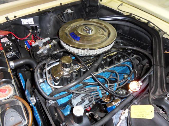

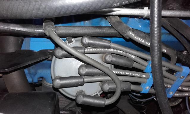

I have power steering with the old Thompson (Thompsen?) pump and DSII on my 250. Clearance is close but works fine.
