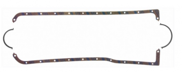

I need your help. I am replacing my oil pan gasket and valve cover gasket. I am a novice and have never done this before. I have been watching youtube videos and reading forums but everyone seems to suggest different things.
I am using the felpro cork gaskets that I purchased from NAPA (Part #: FPG OS12701C)
The gasket comes in two long pieces and 2 half circle pieces.
My plan is to use a light coat of ultra black RTV on the entire surface on surface of the engine to place the long strips on the bottom of the engine. Next I plan to put on the half circle pieces. THIS IS WHERE I AM STUCK....Do I use a thin coat of ultra black RTV to install the half pieces? What do I do there?

Hi, removing the oil pan and valve cover is a really cool experience. I removed my oil pan and valve cover last summer and I was super nervous too.
My biggest suggestion is to take your time and go slowly to enjoy what you’re doing. It is really not that hard of a task once you’re doing it.
Does your oil pan leak at all or what is the reason you want to replace the gasket? If you’re battling a leak are you sure it isn’t a rear main seal leak, which you could change while you have the pan off also. The screen and pump aren’t that expensive and would be a good idea to change. Also, while the pan is off check the looseness of the timing chain, if it’s too lose it would be a good idea to change that too. The key to enjoying working on these cars is to take your time and not rush it that’s how I make my mistakes.
I don’t have leaks after I changed my pan and I followed the advice on this video and used the aviation gasket stuff he uses.
the other guys on the forum are super helpful. Also check old posts I have a thread on all my changes I did and there was a recent thread on a rear main seal change. Also check the Performance Handbook if you don’t have it already.

thanks MustangDadDrake....I watched the video you suggested. I am going to put on the oil pan gasket the same way. It helps to know that it worked for you too! I am going to change the oil pump while I got it all open.

didn't view the vids. DO KNOW we have the goods on best practices. C our stickie on pan & VC gaskets thru the search function above... Make sure pan/vc is not 'warped' on a known machinist plain (sheeta glass?) for 1st step. When tightening make sure U do not tighten beyond tolerances as U will warp again...
I am working on the oil pan gasket tonight. I discovered that the rubber seal that I ordered that goes around the back crankshaft is too long. There must be different sizes for manual versus automatic? Where would I find the right size?
There is only one size used be sure you have everthing clean and are getting the two little side tabs going all the way into the grove in the block. Good luck
Update - I was able to get the rear crankshaft rubber seal on - I had to scrape some RTV out in order to insert the tabs. Thanks!!!
