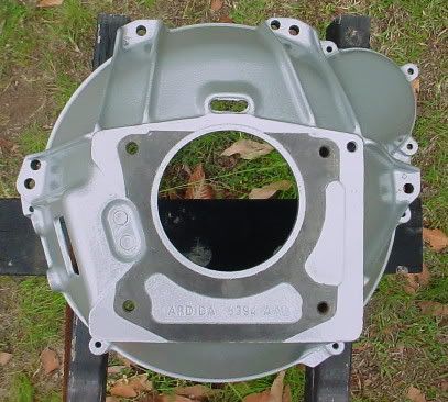

howdy all ive ben having a cleanup and had a spare bellhousing lying about as i was about to toss it into the trailer to go to the tip i realised that the clutch ford came from the lhs as i looked closer its a hydro clutch bellhousing
ive never seen one before so i dunno if its a rare find just wondering if its worth anything or if i should have thrown it on the trailer ??

i really dont know what its for ill take a photo of where the gearbox will attatch to and see if i can find some numbers on it for ya tomorrow

cast into it is ardida-6394-aa
I think it's the one I'm looking for. Do you have a fax? I can shoot some measurements and a sketch through tomorrow morning. Forgotten how dirty they get!

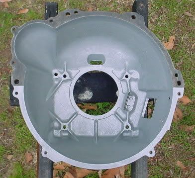

Looks a bit different now. Hot water and sugar soap; gave it a good scrub. Then, hot caustic bath for a day. Rotary wire brushed, and phosphated.
I masked off the gearbox mount area to maintain metal-metal alignment. Paint is POR-15 silver - 2 brushed coats inside, 2 brushed coats outside, plus a light sprayed one.

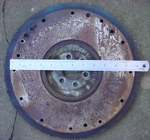

What's the difference? Don't say 4mm; I know that much. But mounting requirements, depth, all that type of stuff? Going (for now) behind an XR 200.
Ummm, no, I'd say 14 mm.
You need the right flywheel unless you want to piss around with pcd and drill and tap holes. If you don't centre the p/p properly your balance will be out, which isn't a major issue. It can be balanced, but it also opens the possibility of destroying throw out bearings due to the eccentric runout. The biggest benefit apart from larger surface area is they are 6 bolt mounted. The XR's and AU's also had positioning dowells. Depth same as any other Ford 6. What will be driving it eventually after the 200?
A mild 221, possibly bicarbureted will be the eventual propulsion. Got my eyes on a Centerforce twin plate clutch in the longer term.
Have two uncut flywheels, and drilling/dowelling a new PCD isn't out of the question. I can't just slap on a later flywheel because the crank bolts are on a different centre. In the unspecified short medium term, I need it to work behind the 200 but that will mainly be just moving the car around - the XP is unreg and rusty...
