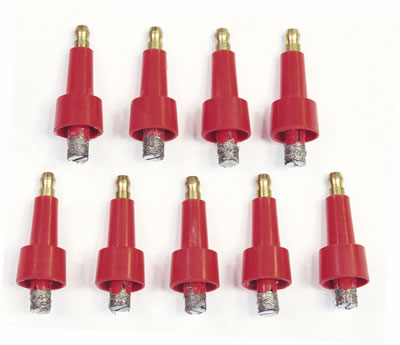

Well I found the actual culprit of my coil arching problem. I found a very minute crack on the side of the tower that was letting the spark "escape" and arch to the + side of the coil. I hope this didn't fry my MSD ignition or my DII distro :( . I believe what caused it was that I installed one of those "Power Towers" and overtightened it causing it to crack :evil: Hopefully I'll be able to find another one here..... :roll:

Ditch the "power tower," it was at best not too harmful with a points system. If it's what I'm thinking of, all it did was add an additional gap/resistance inot the circuit. :shock:
Yeah Tony, I sould've know better.... :cry: I kinda fixed it last night with some epoxy, then fired up the car and everything seemed to be OK, then I turned all the lights out in my garage and I could see some glow right at the base of the tower, also in the plugs where they meet the head, I've never done this test before but I'm geesing there sould be no distinctive glow at all.....right ???????
