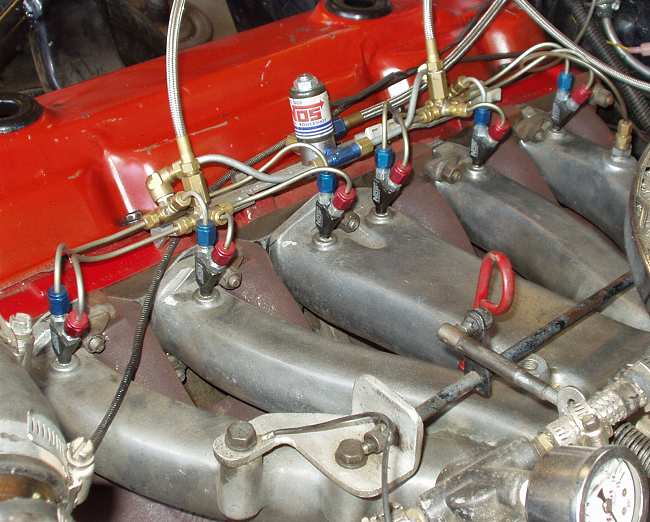

Over the last few days I have become quite interested with installing an N20 setup on my '68 200ci I6. I have the Holley 5200 and dual exhaust so I think some N20 would be a good thing. :D
I have done some research and I see that the best (and safest) way to go is by supplying each cylinder with a nozzle. Where exactly are the nozzles placed? This is where I am getting confused. Are they tapped into the intake log?

Thanks to you and your webpage I cannot stop thinking about N20. :roll: I was browsing around this particular forum and saw one of your posts and linked to your website. It looks like it is easier to install than I thought. I know it is not going to be extremely simple but I was expecting something harder.
When supplying each cylinder wirh N20, I am still not understanding where each individual nozzle would go. Could you give me an estimate as to how much both setups would cost?

On the other hand the direct-port injector kit costs $ 689
This is a Slant Six, but the idea is the same!
