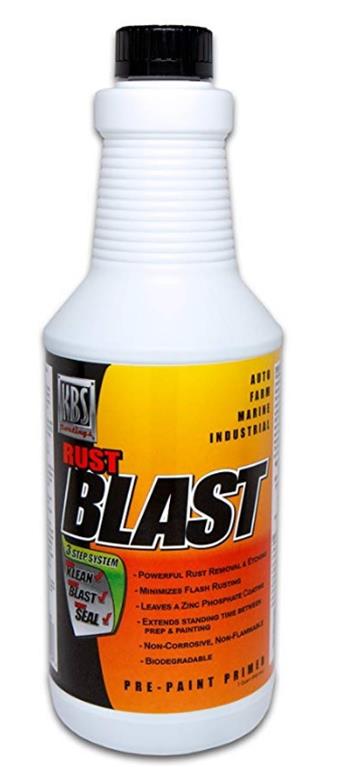

I'm looking at this for my head, it wasn't oiled at the head shop and they handed it to me already with flash rust on it. It's not bad, I can barely feel any texture difference on the gasket surface with my eyes closed.
This should be fine to prep my head with before paint and installation?

Can't answer your first question haven't tried it but sounds like it would work. A good cleaning with a spray (Stiffen Type) air gun to use solvent as a cleaner and then with Tide soap is great for degreasing and cleaning then blow dry with compressed air and spray the machined surfaces with WD40 to keep from rusting just before starting engine assembly. Also used a garbage bag to keep clean in between assembly times.

I would use the Glyptal Red over any appliance or architectural/industrial epoxy coating. While some of the industrial types are highly chemical resistant, most are not rated for continual immersion in volatile liquids or fumes. Then you get to the fact that they arent even available smaller than a gallon, except for those appliance refinisher kits.
The toughest one we sell for chemical resistance is Aliphatic Acrylic Urethane. Its used on gas station canopies and pump islands.
The Glyptal Red is made specifically for going inside an engine.
That makes sense, I'm not hurting for cash enough not to do things the right way.
I've ordered Rust-oleum varnish/tar remover, high temp primer, and ford blue engine enamel from Grainger, Glyptal from Eastwood, and RustBlast direct from KBS. I still need to grab some paint thinner, lint free clothes, and some brushes for the Glyptal.
