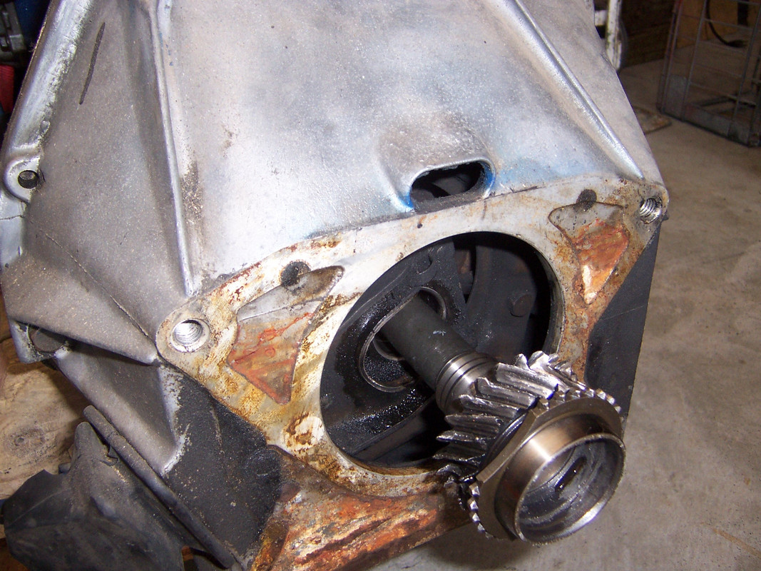

typical dual pattern 200/170 Toploader & bell;

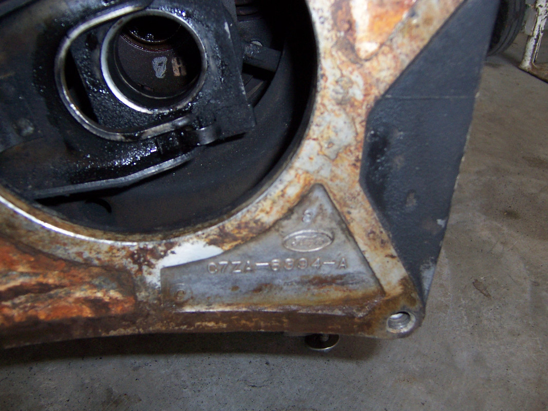

'71 Maverick C7ZA Toploader bell:
