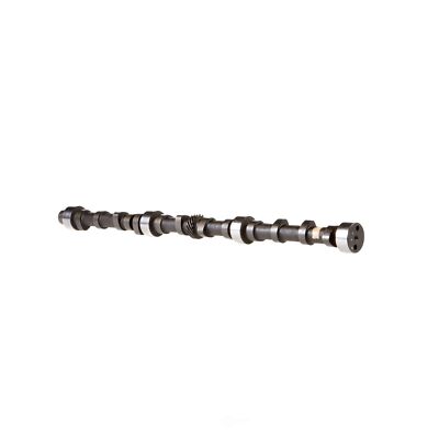

eBay Melling Camshaft
sixtseventwo4d
1K+
Supporter 2022
Firepower354
Interesting that it's called "stock replacement", but the Melling catalog shows it as having .424 lift and 111+3, vs .397 and 110-4.
sixtseventwo4d
1K+
Supporter 2022
Some of the posters here spoke about buying a new cam that was available; since there is a shortage of cores and then sending it out for a preferred performance grind. A little extra "meat" might help with the grind specs.
Heres another one for even less-
I just checked on Melling's sight and they show the lift being .395
