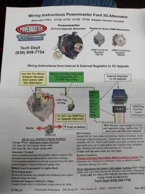

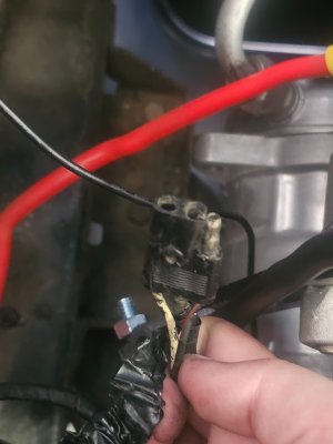

So a buddy of mine had a powermaster 120 amp 3 wire alternator he didn't need so I have an alternator now but on the directions it wants me to splice into the voltage regulator on the green with red wire but the green with red that went to the alternator from the voltage regulator was absolutely cooked at some point in this car's life. How do I wire this now.
Also my plug at the voltage controller doesn't have a red wire. Just white, red with green, and yellow
Or is this saying I just splice into the old external regulator plug at the external regulator and not both the 3 prong plug and regulator plug

You could run a new wire to the regulator, the wiring diagram from Powermaster indicates to tap into one place
Ah ok so I was over thinking it. Then I am able to hook it up fairly easily. That side of the regulator is fine. The part that plugs into an alternator is not

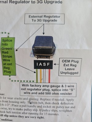

Ok so I have everything but the green wire done. Im a little confused on the verbiage. I have a 3 wire external regulator plug so is it saying that instead of me splicing into the green and red at the plug, I'm supposed to splice into the white wire with a resistor instead?
Also I checked with a light tester thing and the Green wire and yellow are the only one that supply power when the key is in the on/run position
