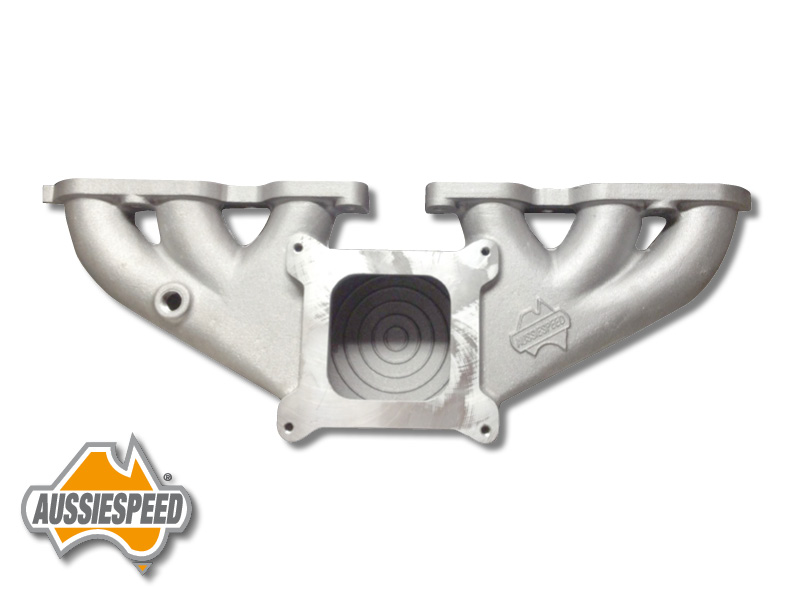

If your going to rework to make your 2V intake a 4bbl one,
then you need to be aware that the air fuel distribution and space limitations will require you to cut the spring tower brackets, and you will have to spend a lot more if its automatic to have a good downshift lever or cable.
The coarser atomised fuel droplets of the Holley 4-bbl will give great power, and 390, 465, 470, 570, 600, 650, vacuum secondary or mechanical secondary, its all able to work from a little 8.5:1 compression 390 Vac sec making 135 hp like kstangs did, or to over 200 hp with 11:1 compression, a big Clay Smith Cam, an 480 Autolite 4100 or 600cfm 4-bbl Holley like some other 2V style headed engines have.
http://www.aussiespeedshop.com/product/ ... ord-250-2v
My recomendation?
Your seriously not going to rework a 2V intake.

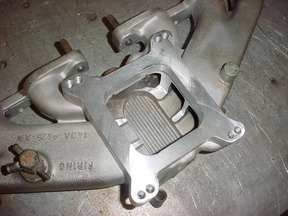

The item on the left is an M code 170 HP 250 2V intake set up for a Holley 350 cfm 2bbl, but Matt Cox sells a good Weber 38DGES and an adaptor to suit the Weber is the same as the uni fit Rochester 2 jet to Weber.
http://www.ebay.com.au/itm/Adapter-Plat ... 1815134804

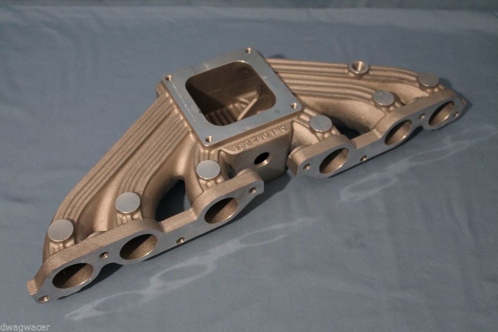

On the right, is the rare 164 HP 221 SP intake for the Argentine head. Basically, the world over, the Ford Six has been experimented with and modified. Just Do it! Take the left bow, do the first steps, and later on, look at a better intake.
Aussie_Falcon_M_code_170_HiPer_250_2V_versus_Argentina_ME188_SP221_with_US_2_BBL_CFi.jpg
The European 2.5/2.8/3.0 V6's ran wonderfully with just a 38 DGES type Weber, a match for the 1.14 Motorcraft, both normally about 300 cfm, and able to make 135 to 140 hp with 165 to 175 lb-ft in those little sizes. Adding the 50% extra capacity of a 200 or 250 to it, and you'll race up to 185 hp and 225 lb-ft fairly easily. Past that it pays to look at the 500 cfm Holley (a 1.38 venturi carb), or the Motorcraft 1.21/1.23/Autolite 1.33.
