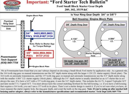

What Powermaster number fits a 67 200 high mount with a C-4 trans?
9103 should fit I have not tried it so I cannot say for sure, but research tells me it should, 3/4'' gear stick out and 4.083 opening only use two bolts.
RobbMc shows their 3001 as fitting and Power Master 9103 fits the same engines but does not list the 200 C4, but why would they.
