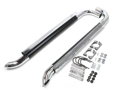

I'm saving up for some dual out headers and some sidepipes for my 66 mustang.
I'm in highschool and working two jobs to afford it, so my question is, is it a good idea?
The mustang is my only car, so basically a daily driver. I've heard stories of people complaining about exaust getting in the car through the windows..
And if i ran straight exaust, as in from the headers to the sidepipes with no muffler, would it be too loud?
I don't want to make a stupid teenage mistake, so thanks for the help
I think some of the side pipes have mufflers in the centre section. It shouldn't be too loud. Also, as long as the exhaust exits behind the doors (which it basically will), you'll normally have enough air movement to pull the fumes away. Idle situations are another issue, but that's one for you to determine. Your most enjoyable exercise will be the LH side connections...

The connection that goes from the headers to the beginning of the sidepipes, would that have to be custom fabricated?

The LH side has to come in front of the tranny inspection plate, to meet up reasonably with the pipes. The fabrication will be costly; certainly more than $100. Your best bet is to mock it up, mount the headers and side pipes and leave the connecting to the exhaust shop. They can use a selection of mandrel bends to make the system actually work as well as it looks.
I didn't say this, but you could probably run your car with straight headers to the muffler/exhaust place with just a couple of turndowns clamped on the ends. :wink:
Whatever they do to fit, make sure it's reasonably removable, as it will need to come partly out for tranny work.

i was looking at those before too, pretty good price considering it looks sweet and is mufflerized...i had it planned out too like addo said, using those wide clamps that do the 360 deg clamp and cost like 10 bucks apiece...i bet u could buy the pipes and clamps for about 100 bucks and do it yourself..the clamps seem to seal pretty good since i have seen many smokestacks put together with them and i dont notice any leak sound. I would get the longest ones u can get...summit sells the patriots for about 260ish bucks for i think a 70" ... i think its the biggest one...i dont have he book here so i cant check, and my internets screwed up and i cant search for stuff...but i think thats right...maybe 72"...but then it should come out right infront of the rear tires..and thats not so bad.
Just nosing around Summit's site... The Walker Dynomax set is about $270 and the Patriots $190-odd. There's another brand for about $600+ :shock: in full stainless. Oddly enough, the warrantly on the D-max is 90 days, on the Patriots one year. Pay more, get more "risk". :?

Yeah I was planning on buying the 60" Patriots (That picture is taken from Summitracing.com) For like $195.
