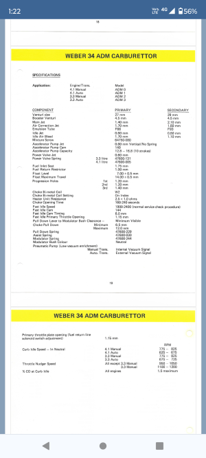

Ford australia used the 34 ADM weber on the 200 /250 crossflows ( XE and XF model Falcons approx 1983 to 1986).
Ford Australia sold about 1/2 million xe +xf falcons here ( not all wth 34 ADM's) - so 34 ADM are cheap to buy here.
34 ADM used 27/ 29mm venturis .
Ford managed to use the same spec ( except for minor items - power valves) on the 200(3.3l) and 250 ( 4.1l)
32/ 36 used 26/27mm venturis
Ford Australia Training bulletin here:
Specs here:Screenshot_20240917-132239.png
