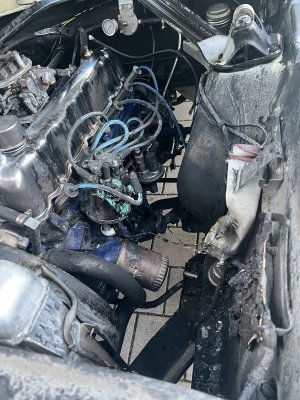

IMG_6320.jpegHey guys,
I had actually planned to continue working on the car today and also tell you about the awesome Tremec Toolbox app, which you can download from the App Store. It lets you measure the angles of the transmission, driveshaft, and differential. Really neat tool—you can instantly see how much correction is needed. Pretty cool stuff! 😊
But then this happened yesterday…
When I tried cranking the engine for a moment, it happened: a spark from the distributor… and suddenly the whole car was up in flames. 😞
Lesson learned. 😳
Everything happened so fast. Luckily, I immediately shut the engine off, and with the help of my neighbors we managed to get the fire under control within about two minutes. But wow, it still did quite a bit of damage. I’m afraid I might need two or three new hoses. 🙈
Jokes aside, it was honestly shocking how incredibly fast everything started burning. The night was very short—I spent a lot of time thinking “if only I had…” but it’s too late for that now.
In my opinion, the location of the mechanical fuel pump is just terrible. That’s probably going to be the first thing to go. I’m most likely going to replace it with an electric Holley Mighty Mite, and then we’ll see what else needs to be renewed. The distributor definitely isn’t looking too healthy anymore. 😅
For now, I still have a 1969 distributor sitting on the shelf, and I should also have a Pertronix module somewhere. A few wires, hoses, and gaskets, maybe a carburetor rebuild, and hopefully she’ll be running again. 🙈
I had discovered a fuel leak at the mechanical fuel pump. As soon as I noticed it, I tried to fix it. Apparently, the fitting on the carburetor side had worked itself loose. When I tried cranking the engine again for a moment, it happened: a spark from the distributor… and suddenly the whole car was up in flames. 😞
Lesson learned. 😳

It looks like you got it doused before too much damage was done but I’m really sorry to see that. I hope the damage to the distributor was limited to the cap, rotor and wires. Everything else looks cosmetic and salvageable.
These mechanical fuel pumps certainly aren’t making a very good case for their continued use. Moving forwards, I’d suggest getting a small block ford fuel pump block-off plate and switching over to an electric fuel pump once you’ve cleaned up the havoc the fire created. I’m sure you’ll be back on the road fairly soon.
@powerband and bmbm40, I agree with both of you. I did have a small fire extinguisher in the car, but looking back, it was more for peace of mind than anything else—it was empty almost immediately. 😮‍💨 Next time, there will definitely be a larger one in the garage. And yes, pushing the car out of the garage is definitely a good idea. 👍
Fortunately, we were able to get hold of some larger fire extinguishers quickly, which allowed us to bring the fire under control fast. Unfortunately, not quite fast enough, as it still caused a fair amount of damage. The hoses are actually the least of it—the distributor, alternator, numerous wires, and even the paint on the hood has started to blister, among other things.
But I’ll be off work soon, and then the rebuild can begin. Whether I’ll have it finished by its 60th birthday, I honestly don’t know yet, but I don’t want to leave it sitting like this for long. It smells absolutely awful—the melted rubber and plastic parts are just disgusting. 🤮
@Andrew, yes, you’re right—the mechanical fuel pump is definitely going. Holley makes the Mighty Mite in several versions, and the smaller one would be perfect: 25 gallons per hour at 3 PSI. Combined with an inertia/crash switch for added safety, it might even be possible to eliminate the fuel pressure regulator. That would make the engine bay look cleaner and remove one more component that could potentially fail.
