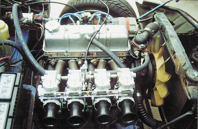

the idea is to mount six of them like this:
I think that may solve some of my dizzy clearnace problems at the same time. Each of them has a 36mm (1.41") throttle so there should be more than adequate flow. I tried to get some 38mm flatslides, but those are hard to get and more expensive.
Interesting - Mikunis, aren't they, on a Spitfire? A mate has a Spitfire ('69, I think) factory built to Le Mans spec - lots of GT6 inbuilts and a host of factory made custom parts. Think it runs Webers...
At least you won't have the obstruction issues with side-draughts like the Webers in a car with shock towers.
The Mikunis should fit nicely in the Locost, but I have lots of room for DCOE's too, should I ever go that way.
THe Mikuni/Spitfire thing has been done dozens of times and by all accounts is a great combination. The cycle carbs idle well but flow like crazy when opened up.
Fuel pressure has to be set low, so I have a regulator that I will dial down to about 2 psi, but I think the stock pump will do the trick.
