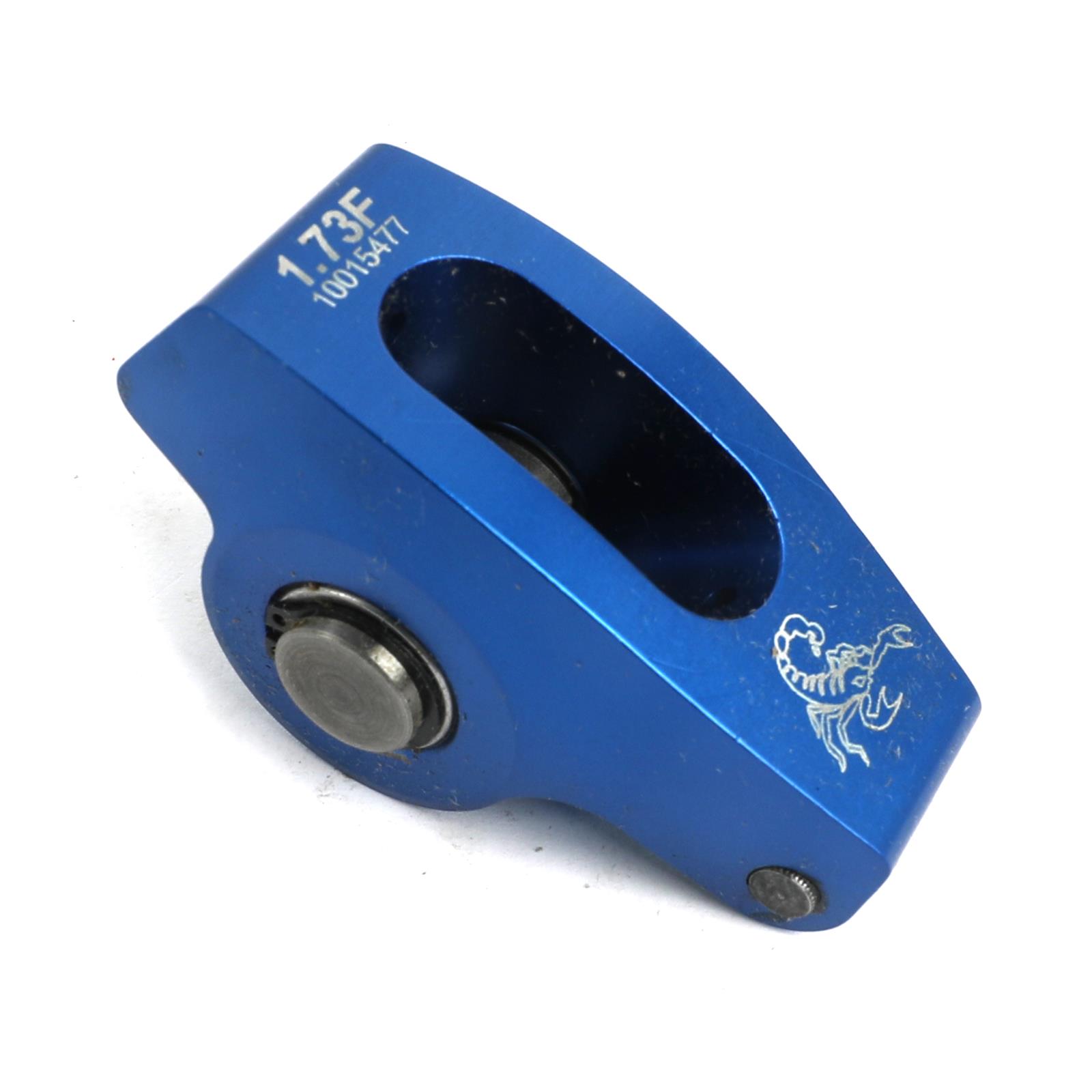

The Promaxx head with Scorpion roller rocker arms alone will increase the power enough where you can use the stock cam for turbocharging.

The Scorpion roller rockers
