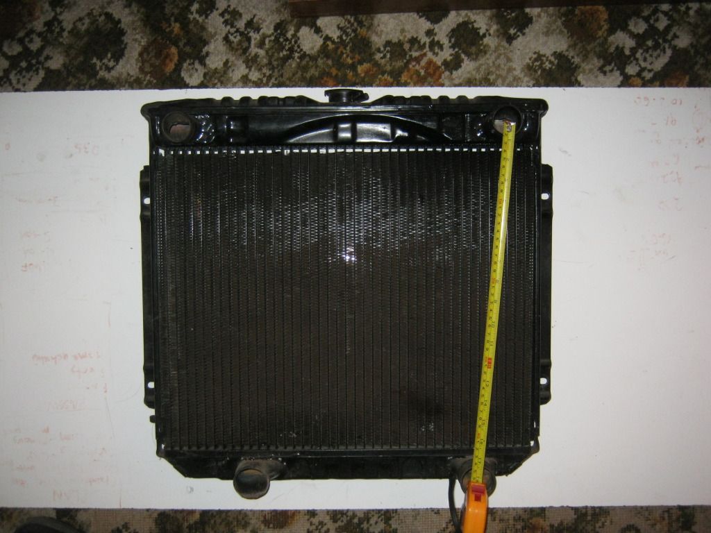

My 1978 XC Falcon was the last of the good old non cross flow radiators. Most Round body and Ranger/Explorer V8 replacement radiators are like these
Spacing from top tank passenger side out let to bottom tank passenger side inlet on mine is 18 inches. Matrix is 2 inch thick, 16 inches tall by 20 inches wide. I specified a uni fit radiator, with four holes just because you never know what Ford is going to change on its 144 to 351 cube engines.

Its the stock Australian radiator , used on all tall 8.425" deck Argie/Aussie 188/221 from 1968 to 1970 and 9.38" deck200/250 sixes from 1971 to 1978.
Our 200's were short deck till 1967, then there was none, then it became a destroked 250 engine with its tall deck
The XC Falcon 500 I bought in 2003 had a stock radiator, but a 2753 cc 92.5 hp Nissan LD 28 diesel and Datsun 280 Zx non T5 5 speed from a kind of Datsun Maxima type of thing.
The bottom and top hoses were reversed to suit. I had to put a 1980 iron head 250 X-flow back in it at 196280 miles...Then it got an EFI from my 1987 Fairmont wagon. Everything was different between the Ford sixes and the Nissans for hoses, so it was eaiser to have Radiator Services in Dunedin solder and braize. Had a lot of fun making adaptors on that little baby. The Diesel had the more power than the 200 US six for the same year
http://media.photobucket.com/image/XCTA ... C02237.jpg
http://img73.photobucket.com/albums/v22 ... 6e572b.jpg
