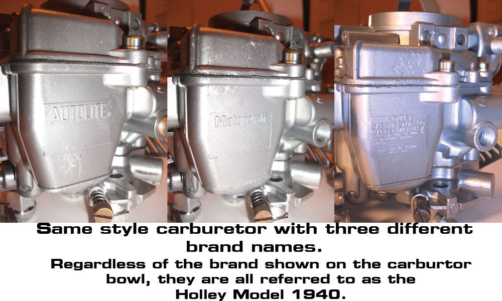

Well done, texasrat67, if the throttle trunnions are still able to be rebushed, then fortune has found you in this instance but what with SCA and non SCA, and the three different carb brands it was stamped with, what a Bar-steward of a carb they are to find. No one has really covered off the 1940/1100/1101 differences in a correct and comprehensive manner, but David (CZLN6) the co-author of the Falcon Performance Handbook on http://www.falcon6handbook.com/ has done the lions share, and I only have a few details to add.
Sadly, there are two sizes of 1940 Holley, a 1.4375" throttle with nominal 1.125 venturi and a 1.6875 throttle with nominal 1.375" venturi. This is one of the only Holley carbs to be sized not by a Holley part number convention, but by Fords Basic Part Number suffix plate. This means not all 1940's are even close in cfm...they could be as good as 212 cfm for a big 223/262/240/250 or 300 carb like yours, or as little as about 160 cfm at 3.0"Hg for the little 144/170/200 stand in item. David lists the cfm's in some detail for stock carbs, but there is no common factory info for the 1940 variants...you have to track down obscure HP book "Holley carburetors and manifolds. ISBN 0-89586-433-9 . By Mike Urich and Bill Fisher" to get close to the right cfm's, and the smaller 1940 160 cfm flow is an estimate based on what the 1.10 and 1.20 1100 Autolite flows. The 1101 1.29 flows about 210 cfm.
R 4523 AAS, additional BPN plate suffix D, is indeed a big 1969 Ford Pass., 250 Eng. Std. & Auto.carb, one of the good ones which flows 212 cfm and has a blue print 1.375" venturi which varied in practice from 1.352" to 1.386" in venturi size depending on how accurate you measure it.
