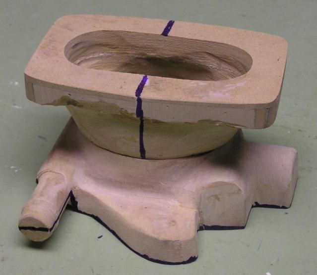

aribert devised an adptor that used the water heated baseplate, but it was just a development for the other kind of 32/36 Weber, a reversed Pinto 5200 Holley Weber carb. Lots of work to make it fit. Pinto/Stovebolt adaptor is way easier.
