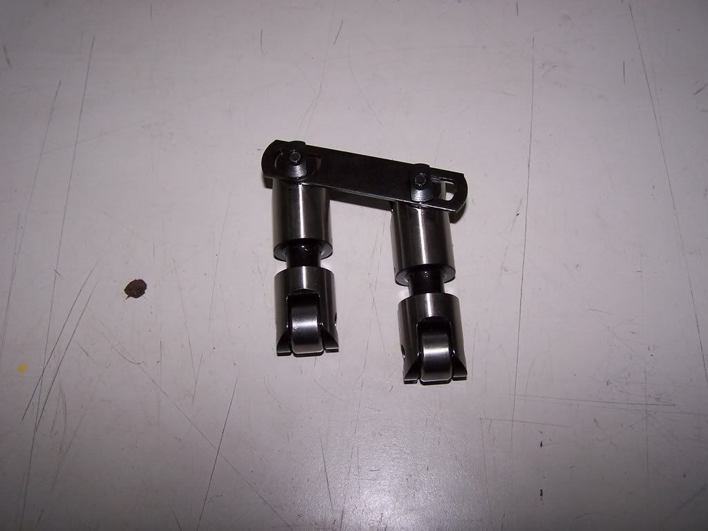

viewtopic.php?p=581111#p581111
Looks like the Comp Endure X solid roller lifters with removable link bars for BBF can be made to work
Contact Bullet Cams for a billet roller cam.

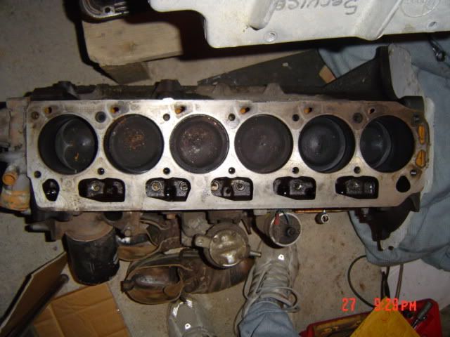

250 with small port Aussie X flow head.
Roller converted block, similar to how the Argentinians do it, although they just use studs to center the rockers with less drilling.

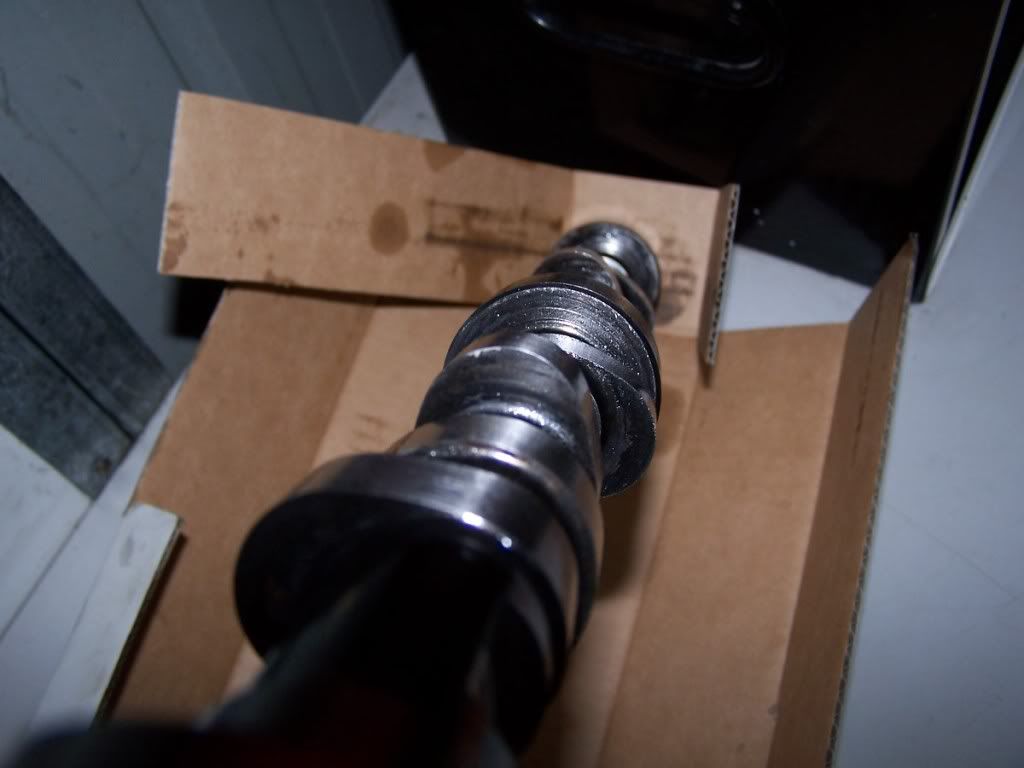

Solid lifter Tigue Roller cam with about 290 degrees duration at lash, wide 115 lobe center, 235 degrees at 50 thou, 528 lift at the valve for 1.73 lifters.
CarMichael Angelo, the artist formerly known as mike1157 wrote:https://www.stangnet.com/mustang-forums ... pg.595758/
Noisy or not,....this cam makes 19" of vacuum at idle, boost at 2500 RPM, and at 30% throttle. If there was ever a more perfect grind, I don't know what is......I'm thinkin that ill leave it.

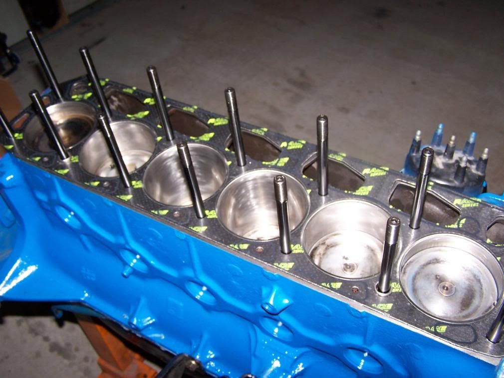

Engine
Progress Thread - The Official Gila Monster Build | Page 10 | Mustang Forums at StangNet
Basic Block Mods-lifter galley clearancing
Progress Thread - The Official Gila Monster Build | Page 15 | Mustang Forums at StangNet
Deck widening:
Side Plate:
Progress Thread - The Official Gila Monster Build | Page 16 | Mustang Forums at StangNet
Oct 24, 2013 Post #189 to Feb 17, 2014 #323

mike1157 wrote:Spent the entire day finishing the side access, and the cover plate to seal it up.
Since Birmingham is another "steel city," getting the proper material to do the job is only a matter of knowing where to go. Some time ago, in anticipation of using it to make a header flange, I picked up a 2' long piece of 7/16" thick angle.
I decided that that was what I'd make the cover plate instead.
Let me tell ya, whatever the original intent of that piece of steel was, using it to make a cover plate proved a challenge. This stuff has to be the hardest steel I've yet tried to cut with standard home shop tools.
A jig saw? No freakin' way. A sawzall w/ a brand new 14 tpi blade? Laughable.
I have a hand held band saw, but the cut I had to make was too wide, and the stock hit the saw, and the cut was wandering all over the place.
Solution? A 39.00 4.5" angle grinder w/ a 1/16" cut off wheel.
I had the piece cut in 5 minutes.
I had already cut all of the access holes a few days ago, so after I got my piece cut, I finished cutting out the nooks, and crannies required to make it fit.
The other thing I did when I cut the access holes was flatten the mating surface. No easy task considering all I had to do that with was that same angle grinder, and a mill file.
The next thing I did was fit that plate, and measure for the gazillion 1/4- 20 holes that I had to drill, and tap around the perimeter of the opening.
I bolted the bottom plate using 1/4 x 3/4 Allen head cap screws. The top plate is glued to the block, so I added a .095 piece of 1-1/4 bar on top of it, and bolted it to the glued plate to bring the top plate level with the bottom, so I could add the gussets I planned for earlier.
Now the problem w/ adding those gussets is that they are sitting directly on top of another plate tat is epoxied to the side of the engine. It doesn't take a brain surgeon to determine that the heat soak that would come off of trying to weld those gussets in place would compromise the bond of the epoxy. So I tacked it in place, unbolted it, and moved it to another piece of 1/2" flat plate that would act as a backer to hopefully keep the cover plate from warping when I welded it.
So a few of you may be thinking that I have solved the problem of being relegated to using a future failure flat tappet camshaft.......and may be considering doing the same.

The log head block hasn't got the open area the cross flow block has, so it needs heroic metal work to get enough room to fit the roller followers in a non cross flow log head.
The Argentina SP 221 block used for TC3000 and 4000 has twelve pilot holes drilled, and its relatively simple to solid roller lifter them. Making a cross flow head adds a whole 'nuther level of complication to it.

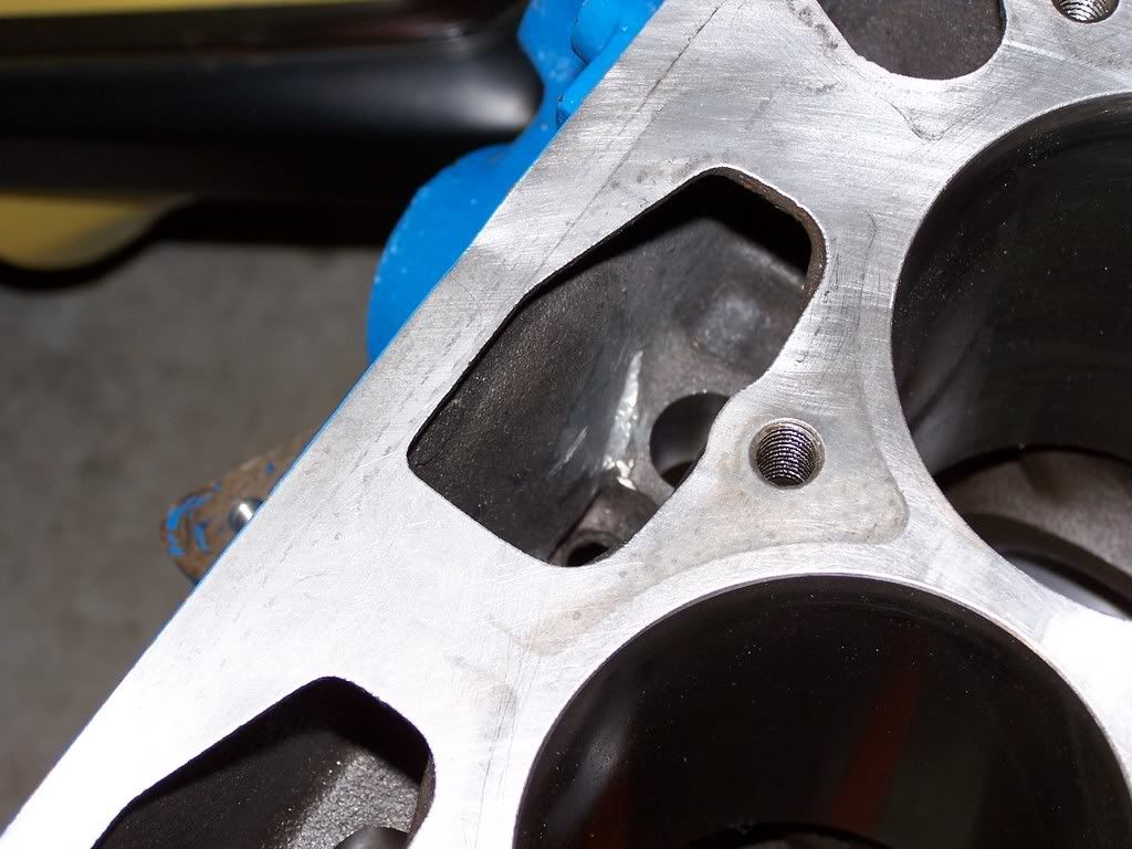

The Todo Falcon SP221 Roller Cam conversion kit has dropped off the picture list,
Whatever we dream about, the Argentinians have already done...many, many times

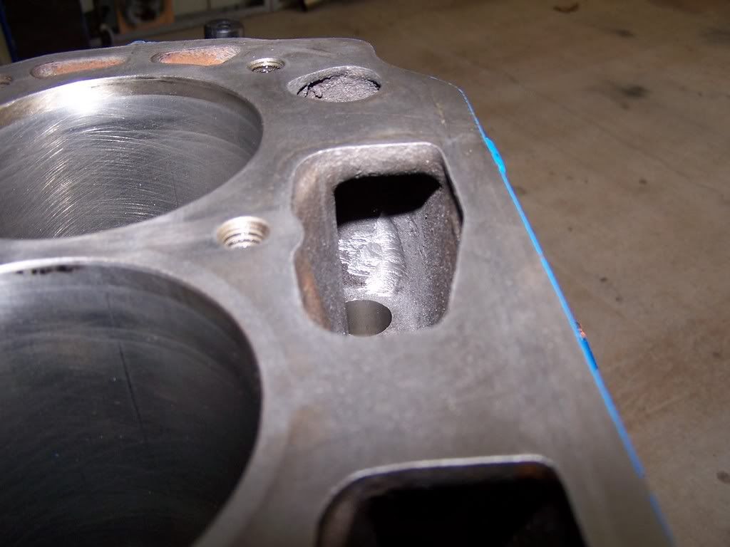

so all I can do is show you the Aussie X flow block roller cam conversion, which is simarly simple.
Care of CYCO250
Roller camming a tall deck 200 or 250 x flow block is way, way easier,
just relieve the roller rocker space with a dremal, and by a roller cam and a set of NASCAR R452 spec roller followers (351 Windsor Cleveland "335" style, with "385" 429 to 460 link rod width.

The basic differences are in Mustang Sixes Crossflow Chronicals and the Locost X flow head conversion in the tech section.
Here are some extras.
Width on US driver side, extra 1 inch
Stock Log head exhaust collides with stock Cross flow block and its extra inch of block
Log head on Cross flow block won't cover rocker chest holes, due to that extra inch of block width.
Stock log head gasket verses Cross flow block at back by bellhousing
Stock log head gasket verses Cross flow block at front by water pump
Whole log head gasket verses whole cross flow block. Width overall is 1-1/2" wider at head gasket face.
Comparing the 200 1966 Log head block with the stock alloy head Cross flow head gasket.
The whole Cross flow block is a heap wider with different water galliers and more void space for the canted valve heads pushrods

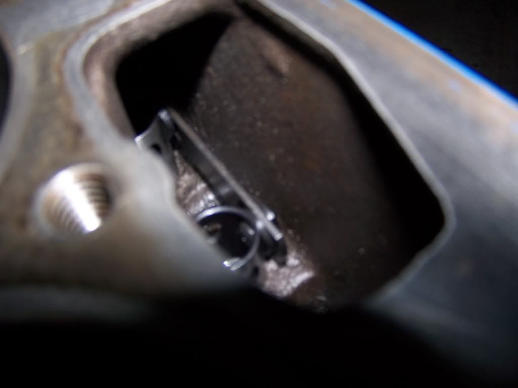

On the other SBF engines, just a Spider gusset is enough to retain the roller followers
On the SP 221 for Turismo Carretera, the followers are cross bolted into position like this
contact fakundo__92 on this link. https://www.fordsix.com/viewtopic.php?t=78991
Watch the videos.
That is how to make a roller cam log head in line six work.
