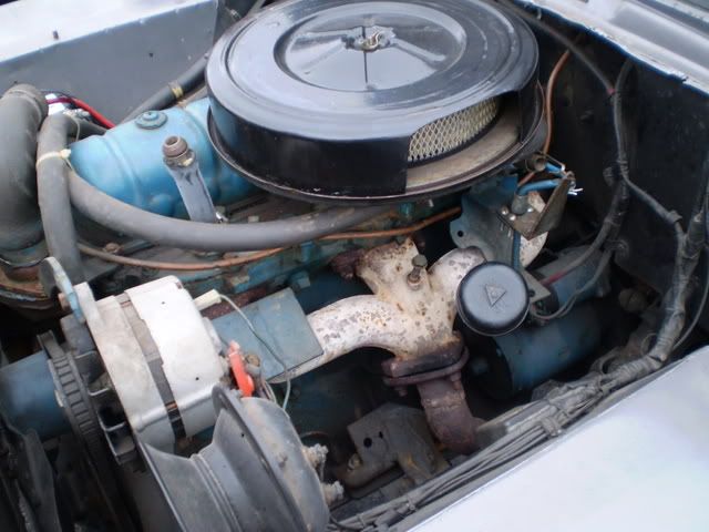

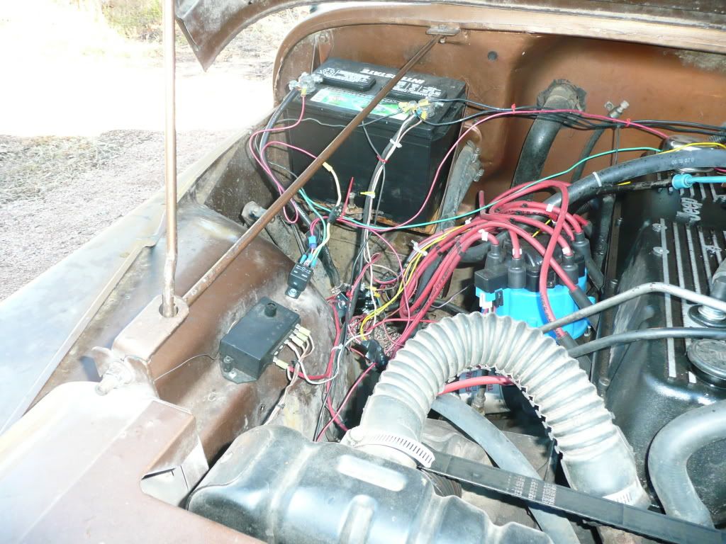

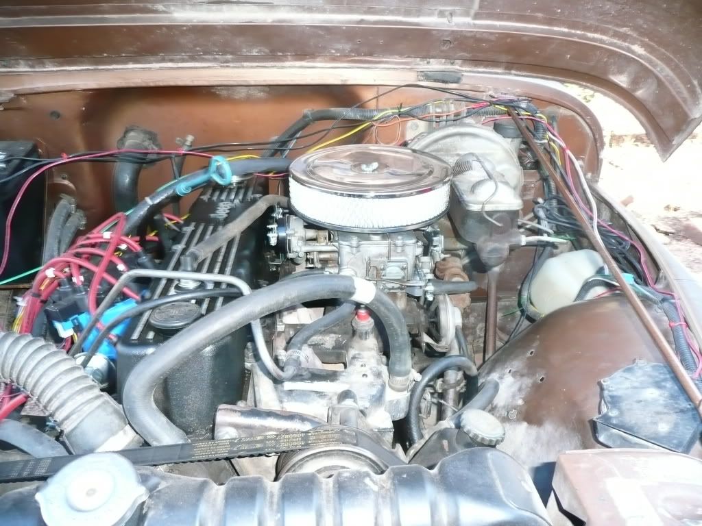

Here are a couple of shots of the inline 6 out of my Jeep - 80 CJ5. Not close ups, but you get the idea:

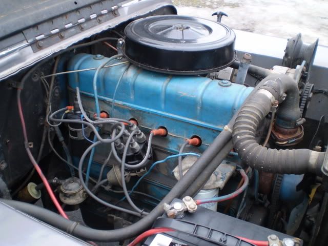

Well dialup users are going to hate me, as the pictures you sent were almost 2mb each.. but I uploaded them via my phone which doesn't have any image resizing software on it, yet, anybody got a suggestion for WM6.1? Oh ya, I don't know what it is. I can tell you that it is NOT a small six ford (144/170/200/250) I can tell you that it is not a 216/223/262, and I can also tell you that it is not a 240/300. I also know that it is not any of the Chebby sixes that I'm familiar with (230/250/292/235). It's not a slant6, nor is it any of the 232/258/4.0 family of sixes.
Here are links to the photos:
Can see distributor, and what looks like a remote oil filter, fuel pump is mounted down low on the rear of the block, right below 2 side side covers. You can also get a good view of 2 large hoses that are being plugged by lugnuts, which I find interesting, th emotor appears to be 'vintage' but the hoses suggest emission controls..
Passenger Side
Can see air cleaner, alternator, exhaust manifold, starter/starter solenoid (looks like GM type starter) homade motor mounts.
DriverSide
befuddled,
-ron

I've posted the pics on my Jeep forum and will ask what it is. Likely the original engine.
I shrunk the pics down and loaded on Photobucket. Here they are:
Image Image
-Vinny

Post #17 by eeyore » Fri Feb 27, 2009 10:04 am
Looks alot like the early Ford. The 215, 223, 262 family I'm not sure, check out this link. http://www.geocities.com/edwins63/ohvsix.html
Dave

Post #18 by wallaka » Fri Feb 27, 2009 10:16 am
Not a Willys, Pontiac, Studebaker or Kaiser either.
Down to 29 cylinders!
2006 Porsche Cayman H6, 1968 Mercury Monterey big block (390), 1967 F-100 240, 1965 Mercury Comet 404 (200), 2009 Triumph Street Triple

A reply to my post on the Jeep forum. PO=prior owner.
www.virtualjeepclub.com wrote:The PO of my Willys Wagon repowered it with a 1950s 223-6 Ford engine. It kind of looks like the one you posted.
The air cleaner is a 'space saver style' that was used in some Ford cars of that period.
The PO was very creative in getting this engine to fit in a 1954 Willys Station Wagon.
-Vinny

The oil filler looks like it's in the valve cover. The one I looked at had the oil filler on the rt side with no holes in the valve cover. Still a mystery. Smitty

According to the pictures on edwin's site the starter is on the wrong side, and I don't recall seeing any old Ford starters with a solenoid attached to them.

For what it's worth, I forgot to mention on this forum that the "FORD" script was stamped on the alternator bracket. It may just be a Ford alternator bracket on a different make engine. I'm hoping that if enough people see these posts - someone will have a definite answer.

Here is the definitive answer I got from the jeep forum:
"Its a 58-65 AMC 195.6 came in ramblers and such.
First off is the valve cover with the screws that hold it down, second is the fuel pump at the rear of the engine, third thing I noticed is the exhaust manifold has three branches with paired exhaust runners, The last thing is it has an AMC style distributor. I could tell its not a ford since the carb and exhaust are on the drivers side, I think fords are always passanger side (not sure though).
Vin man I am pretty sure the later AMC 6cyls can be swapped in place of the 195.6 wih a change of the motor mounts. If I remeber the bellhousing bolt pattern is the same, Dont take my word though, you might want to research it a little more. If I remeber right the 195.6 requires head retorquing every 8-10,000 miles"
