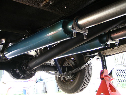

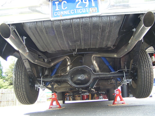

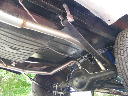

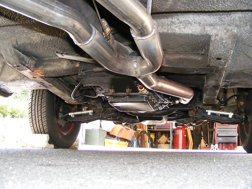

I'm hoping you all can help me with this problem. I had a custom exhaust put in my '62 Comet (stock '71 Maverick 200 drivetrain). It is 2" stainless that comes down from the manifold in one pipe, splits into duals, passes through Smithys glass packs and goes to the rear (ignore the megaphone tips, those were and error and have been removed). It looks great, but drones unbelievably at highway speeds. Your whole head vibrates and you can't carry on a conversation.
Basically, does anyone have any suggestions oh how to fix this? I've had all sorts of suggestions from replacing the mufflers to adding resonators, to reversing one muffler to cutting it down to single exhaust, etc. I'm looking to narrow it down before I throw more money (I really don't have) at this.
Shots of the system:
