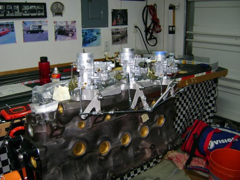

my next project,,,maybe you like the photo's.
now i gonna make my 68'moter with triple carbs.
my other was a 70'moter,the intake from the 68'
and 70'moter are different,,68'has a round log the
70'has a flat log.
greetzzz,,,JD,,,,(from holland) ;)
pictures of my 66 Mustang with my homemade tri-power that I built with the help of the combined experience of this site.
.. very nice implementation, tri-Power is a functiional intake design and it's form follows and it shows ...
xctasy's ambitious project of individual runners ' and multiple progressive's logistics adds plenty more variables to an already considerable task. I've been working (toying) toward multiple 5200' pgsv's with plenum box on top of sectioned log or ... .
