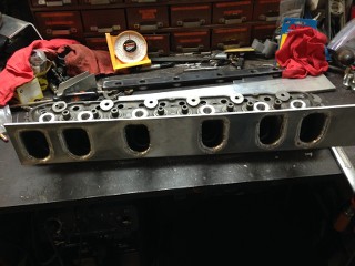

I just finished individual runners on a 72 head. I machined off the entire intake - pictures below (I hope - first time trying to post pictures)
It's fuel injected but it might give you an idea for an intake.

67Straightsix... what can I say but props to you man, and Well done. Your wife will love it when your finished.
67Straightsix-Nice workmanship (y) Can appreciate the time involved as my 72 head involved a rough cutting of the majority of the log dia. off. Then some port work and stubs of 1 1/2 dia exhaust tube cut out of elbows formed to fit the somewhat rectangular shape. Used enough of the elbow to get the port angle to about 11 deg.(going to use carbs and not have to large a scoop protrusion) and enough straight to get 2 1/2 in. stub to attach to using 1 1/2 radiator hose. these stubs are unified to the head with stuff called lab metal-a one component JB weld type material. The 1.4+ inside dia. of the exhaust tube smoothed out well with a little help from the lab metal. The log manifold and runners is a story in it's self and developing :roll:
Your runner dia and head flange opening dia. looks bigger than my 1 1/2 O.D. stuff. how large did you get the port in the head casting? Intake valve size?
Like to see Visards article as I still have trouble visualizing that little port working at high RPM.

First off - xctasy, the amount of information you come up with is amazing! You helped a lot with my design. The two runner to one carb would be
a neat idea for the our 200's. I posted the pictures because I thought splitting the plenums into three separate parts for three two barrels with
the straight runners would be the least restrictive air flow. The runners should have a bit of a venturi effect because they're tapered. The downside
to this design is the carburetor will sit above the hood-line.
The valves size is 150 exhaust - 175 intake. The runner diameter at the head is a little over 1.5" and tapers to roughly 1.75".
