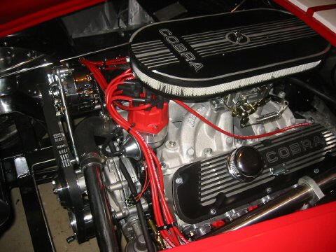

You could use the Cobra6 style Shelby Cobra/FE 427 tripower air cleaner Slade ran on his 200. If money was really the pimary consideration, The inserts are just 30 bucks I think. but its wider and covers more area, and you need access to the throttle linkage.
His photos have dropped out...this is it without the air cleaner,
this is a Cobra style air cleaner he ran.
His tripod site doesn't allow global viewing, so here is a screen dump
