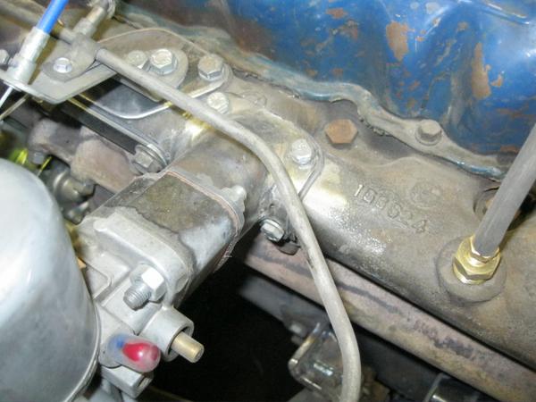

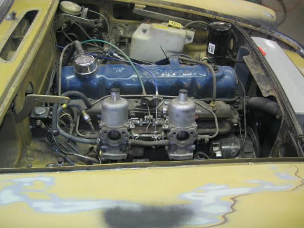

Found a couple more pictures. Very interesting swap.
You've got to love that carb mod. I've recently thought 2 synchronous 1 barrels split out like that would be ideal for these engines. Very cool. I would have gone a little further apart though and put them right inbetween 2-3 and 4-5

I've seen plenty SU carbs (Brit, Italians & other European) but never w/those 'cans' on em.
Some kinda air cleaners? Why do U never see em on other SUs?

Can anyone share additional details on how the side draft carbs were mounted to the log head? It appears short stub manifolds were mounted on top of the log, and the original carb opening blocked off. I would be interested in seeing a bit more on that.
