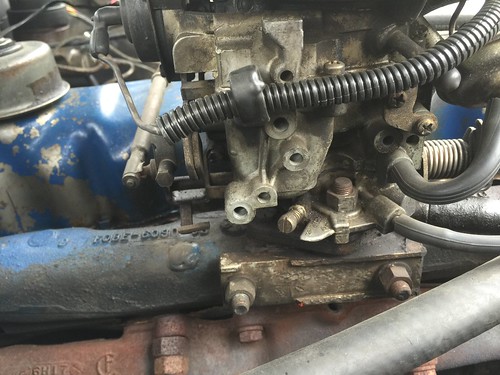

Hey guys,
This is my first time posting here but I've been lurking for awhile. I've been searching around trying to figure out what carb I have in my 63 Comet 170. I thought it was just a stock holley carb but there is a wire coming off the automatic choke area that connects to the coil. Made me think it was an electric choke. So I'm at a loss. If I can figure out what it is, I will be able to work on my idle and be able to order a rebuild kit for it.
Please ignore the dirty engine bay. The valve cover gasket has been leaking for probably the last year + so I've been delaying taking on the job to fix it, replace everything worn out and clean it. But I will this weekend hopefully.
The wire I mentioned connects on the left side of picture and goes into that sheath down to the coil.
The reason I'm asking is because most mornings I have a rough cold start, takes 2 or 3 times to start it. Feels like it's lacking fuel. Once it is running, it misses and idles a little rough. It will stay like that until it's been warmed up. Then when I'm cruising at highway speeds it feels like there is a slight miss/hesitation when I'm coasting at certain speed. Say 60mph. If I'm accelerating I don't notice it, but that doesn't mean it's not happening still.
I don't know when the last time it had a tune up, so that is in the works as well, but a point in the right direction would be appreciated.
I also noticed a couple spots that most likely are leaking air. Potential vacuum leaks. Since I don't have a reference just yet as to this carb setup, can you guys let me know if these hoses are something that I should be concerned with asap. Are they possibly causing my issues?
Old hose, loosely fitted.
S shaped hose towards the middle of the photo, the top connection looks very loose. It goes to a metal line and down under the car, I think towards the trans but not sure.
Thanks!
That is a Holley 1946.
It's missing some unnecessary stuff if you don't mind babying it.
Is there a port on the side of the choke?
Normally there is a pipe going down to the center of the exhaust manifold that sends up heated air to assist with the opening of the choke.
There is also a pipe that goes to the underside of the exhaust manifold that sends hot air up to the topmost port on the carb.
I removed the choke on mine and just use my foot to get 'er going.

From your pictures those vacuum lines are sure in bad need of replacement. Good luck :nod:
Thanks for the info! No port on the side of the choke that I noticed. And I'll look for the one from the exhaust manifold tomorrow.

Without the heater inlet it would be a later 1946.
I have about a half dozen of these things and they all have the hot air tube in addition to the electric.
My guess is Ford eventually figured out what a stupid idea that was.

Yep E0BE-6090-B and I was guessing it was an electric choke since there is the one wire going from the coil to the choke. I'll check the block casting and freeze plugs.
The valve cover gasket is leaking, so ignore the mess. Also the radiator inlet/outlet are both on the PS. So there is extra hose going down and around. Something I will address at some point but right now it's working properly.
