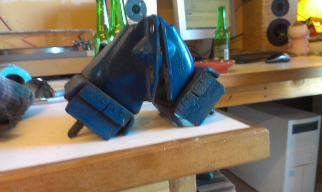

Frame and Motor mount comparison
Parts compared
'67 Mustang
C7ZA-6037-A (frame mount)
C7ZA-6038-C (Blue*)
C7ZA-6038-H (Green)
'69 Mustang
C9ZA-6037-B (frame mount)
C9OA-6038-D (mount)
C9OZ-6038-B (also on mount)
Setup
I used a peice of 2 by 2 angle iron for the measuring jig. I started by drilling the lowest hole into the angle iron. I then put a bolt through the hole with the nut left lose so I could swing the assembly. I used the '67 frame and motor mount for the next step. I put a level along the motor side of the motor mount and when it was straight up and down I clamped it with a big pair of pliers and ran a drill down the hole that would be the farthest from the motor to mark the location. I then took the frame mount off the jig and drilled out the hole. After the holes were drilled I bolted teh frame mount to the jig and started measuring.
From the end of the jig to the horizontal motor mount face
'67 9.5
'69 9
With the motor mounts oriented as they would be while holding the motor
From the table to the center of the lowest motor bolt
'67 3 5/16
'69 3
I then tipped the jig over on its side and measured from the counter up to the center of the bolt hole that is closest to the jig.
'67 5 1/4
'69 4 3/4
So according to what I found, the '69 frame and motor mounts should lower the motor 5/16" lower, and they make and adjustment to allow for the wider block. The part that was interesting is the 1/2" setback. I noticed that the '69 frame mounts have oblonged holes in them for additional adjustments. I still need to make measurements for the bolt spacing where it bolts to the frame. You also have to allow for some slight miscalculation of measureing as I did it with a tape measure.
