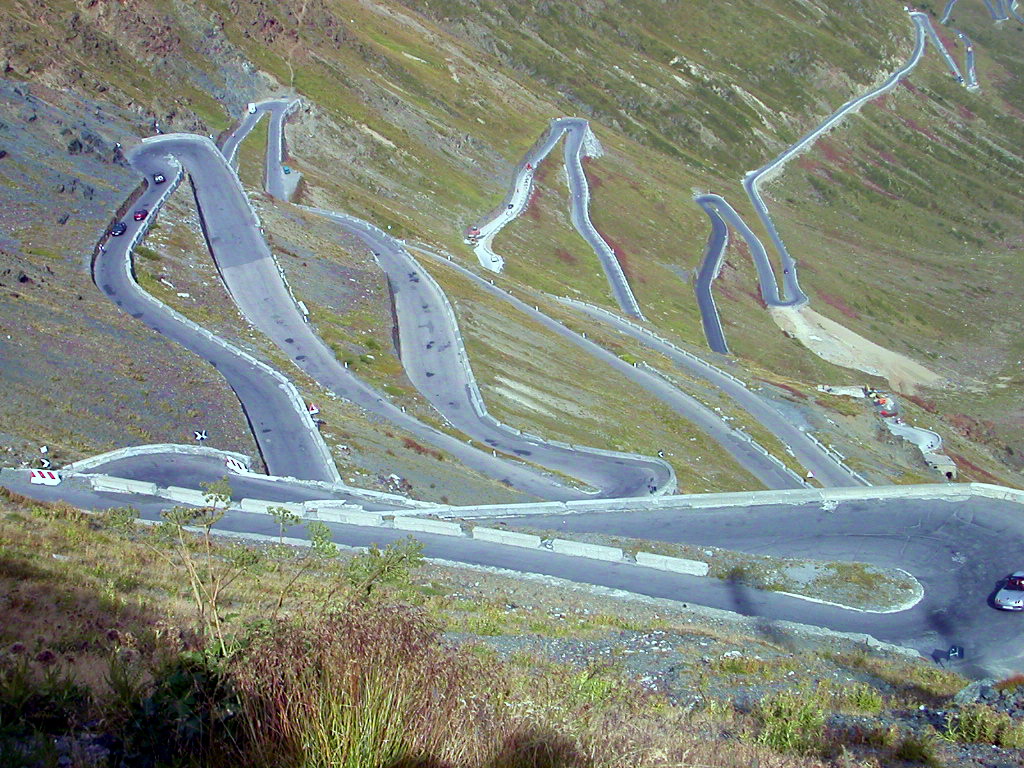

Webers are self compensating. They emulsify fuel, and the venturi action self corrects. There is power loss, but its not signifcant.
That's why in 1970 when calibrating the triple Weber 248 hp E37 and 306 hp E49 Chargers, the Australians used an old US Valiant Hartop and a 20,000 mile drive around Italy, including Stelvio Pass (below).
