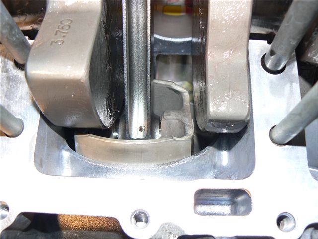

Mike1157 wrote:Well lets see.
Since my last post,..I've been waiting on the engine to get bored at the machine shop so that I could get it back home and mock up a couple of cylinders to determine how much additional decking was gonna be required to bring it to zero deck.
Friday I was able to get it back.
If you look closely, you can see the sleeve. The block has still got .008 that needs to be cut. That'll bring the epoxy that I had to use to widen the deck down to smooth as well.
Those pistons are Racetec 2618 forgings. Should net me a 9:1 CR.
The fact that my name is laser etched on the bottom should be worth about 10HP per piston.:lol:
The rods are stock. Treated to the old school standard for prep: Beams polished, bushed for floating pistons, w/ ARP hardened bolts.
After I determined where the deck needed to be cut, I put the block back on in my truck so that the machine shop can finish it.

We spin Kelly's 250 to 6100rpm at the traps. We haven't used stock rods since that grenade engine, but that was more to do with getting the piston closer to a zero deck height.
We're using off the shelf aftermarket Manley H-Beam rods for a 4.6L Ford V8. They use a standard .912" wrist pin and are .088" longer than the 250 rod. (pretty sure that's the correct number!) The big end is a little smaller than the 250 rod, so you'll need to machine the rod journal to fit....or offset grind it to gain a few more cubic inches.
Because they're V8 rods, the big end width is less. I don't remember the exact numbers off hand, but it's something like .040" less. So the rod will "travel" fore and aft a bit within the rod journal. We haven't seen any issues with that at all! We've torn down the engine numerous times for other issues or just for maintenance, and have never had a problem with that extra rod room in the journal.
Later,
Will
