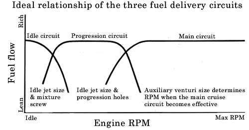

Boost creates a psychotic air fuel response, and Weber 2-bbl carbs feeding six cylinders from one 22 inch long 1.6 inch diameter log with six 90 degree bends are the worst known to man system to tune. Weber carbs are also air calibrated more than just about any other carb system, the Variable Venturi 2700 and 7200 from Ford 1977 to 1991 were too. Boy are they AKWARD!,
Specific to Webers, they require step wise idle, progression/transition and, lastly main system calibrations. Like this.
Unlike triple Weber DCOE 45's, they also have power valves because they are not port on port, independent runner systems. And that means the power valve spikes fuel delivery as well
And you don't even start calibration until you do six thingsl
